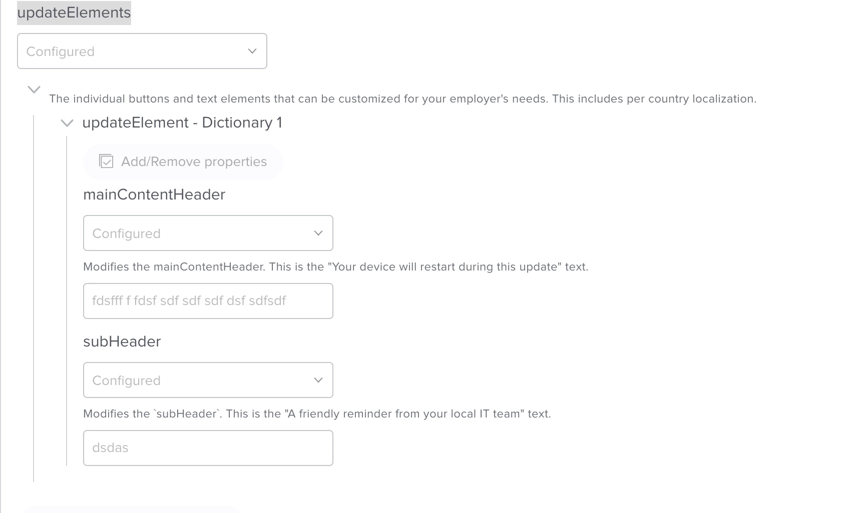

So I have setup Nudge with Jamf and using the JSON shema, which is easy to setup settings etc with the pre-defined settings.
But when it comes to editing the text in the json, the changes I make in the json schema is not listed in the GUI on any device. I have tried to edit all fields possible in the "updateElements" section, but no changes takes effect.
Any one succeeded with that ?

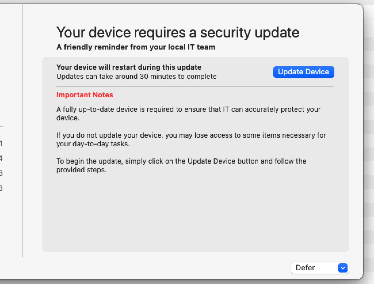

So it just stays the same default view all the time

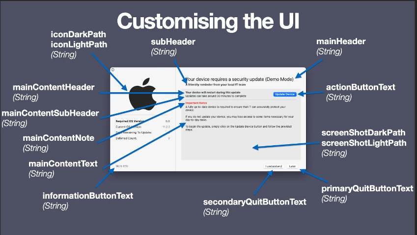

I also use Nudge and love it.  I created my own little how-to document and after reviewing some of the presentations on it available out there on the webs, I kept this as a reference so I'd know what element to edit for whatever I was attempting to say:
Does this help at all?

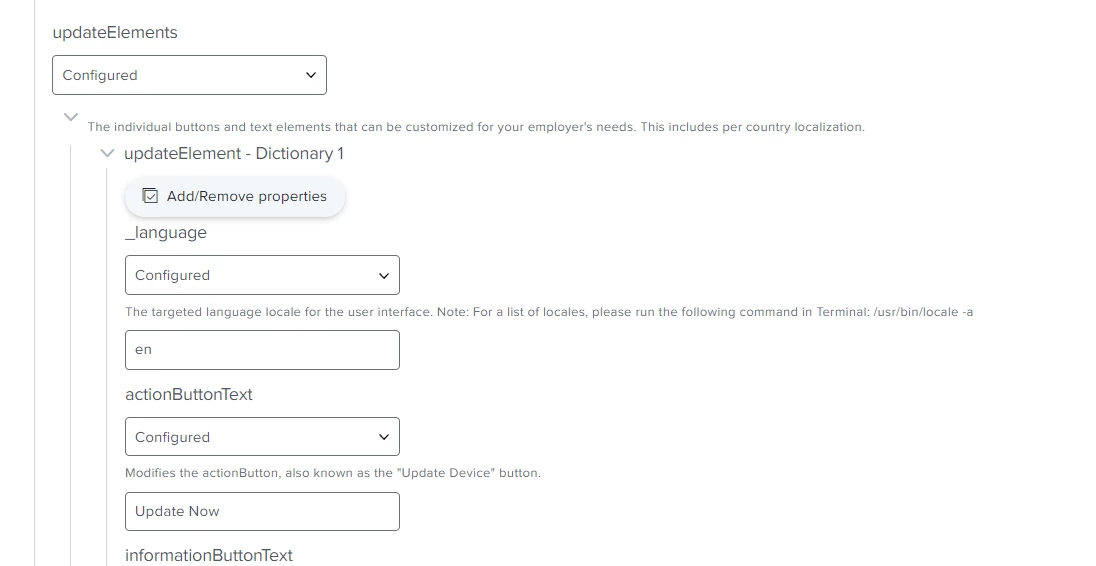

Hey there!
Make sure you are setting your language to "en" or else you will not see changes. Check out the wiki and the first line here: https://github.com/macadmins/nudge/wiki/Common-Issues
Example:
Hope that helps! Also, +1 to the suggestion for joining the slack! Lots of good info over there!
