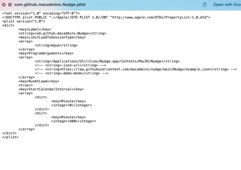

I am using Nudge 1.1 and facing an issue .
Nudge is launching every 1 minute .  
dlondon
  • Nov 3, 2021 8:37 AM UTC
Hi @vinu_thankachan
Not sure about that 480 for Minute.  Surely Minute is restricted to a range between 0 and 59 or maybe 60?
Try removing
<dict> <key>Minute</key> <integer>480</integer> </<dict>
and see if that stops it running every minute.
I'm thinking maybe something like this might work:
<key>StartCalendarInterval</key> <array> <dict> <key>Hour</key> <integer>0</integer> <key>Minute</key> <integer>0</integer> </<dict> <dict> <key>Hour</key> <integer>8</integer> <key>Minute</key> <integer>0</integer> </<dict> <dict> <key>Hour</key> <integer>16</integer> <key>Minute</key> <integer>0</integer> </<dict> </array>

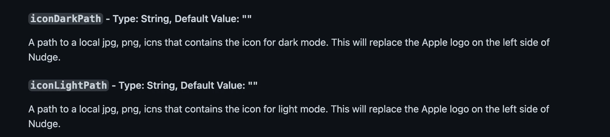

How did you change the apple logo on the left side pane ? trying to do it, couldn't find enough resources. Thanks in advance.

How do you change the apple logo on the left side pane ? trying to do it, couldn't find enough resources. Thanks in advance.
Check this
https://github.com/macadmins/nudge/wiki/userInterface
  • Jul 14, 2022 3:54 PM UTC
@vinu_thankachan The article below gives a great explanation of what you are seeing. StartCalendarInterval is looking for actual times so minute cannot be more than 59. If you put hour then it corresponds to an actual time so <hour>1</hour> would be 1am. If you don't have hour and only have <minute>30</minute> it will launch 30 minutes every hour. Hope this helps. I've found this out through my own trial and error.
https://alvinalexander.com/mac-os-x/launchd-plist-examples-startinterval-startcalendarinterval/
  • Jul 14, 2022 3:56 PM UTC
Sounds like you will want to utilize startinterval with seconds as opposed to startcalendarinterval

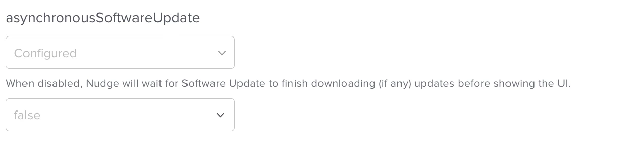

Anyone have tried Deploying nudge with M1 machines ? Nudge doesn't download the minor OS update with M1 macs , with still "asynchronous software update" key set to false. 
