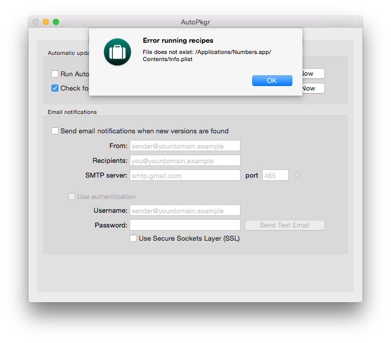

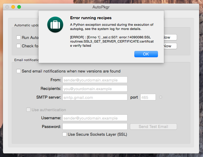

Everything working fine up until we Run AutoPkg Now, then this screenshot below shows the errors which are returned. It could be something to do with our JSS being on a windows server, I read this maybe an issue but didn't find a solution.

Spoke too soon. Now getting a couple of differing messages when clicking Run AutoPkg Now, tried with a number of different recipes and cannot find any pattern.

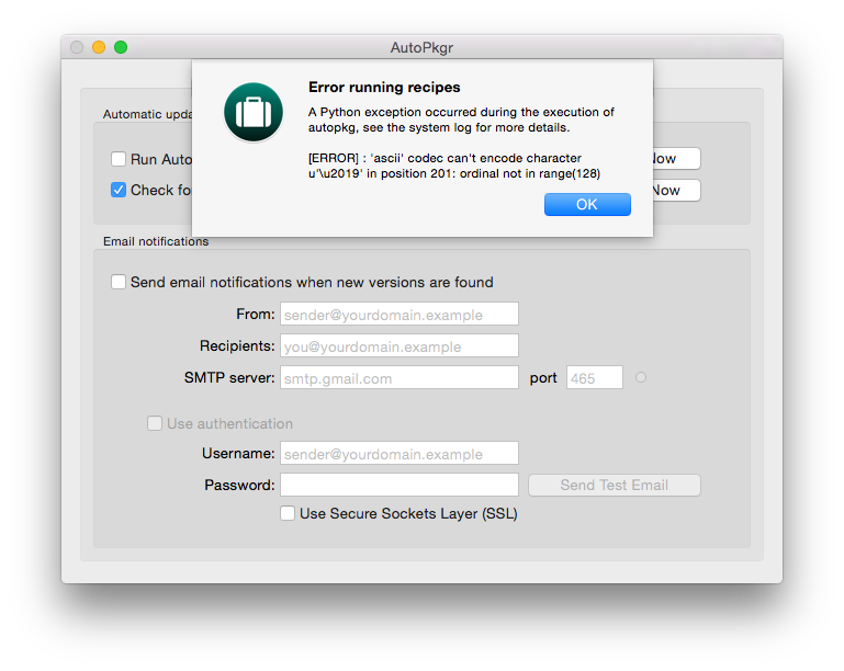

  • July 9, 2015
OK, now getting a different error, any advice please?
  • July 9, 2015
OK, we have fixed this. We didn't have the CA Certificate from our JSS installed on the Mac running AuotPkgr. Fixed now :-)
