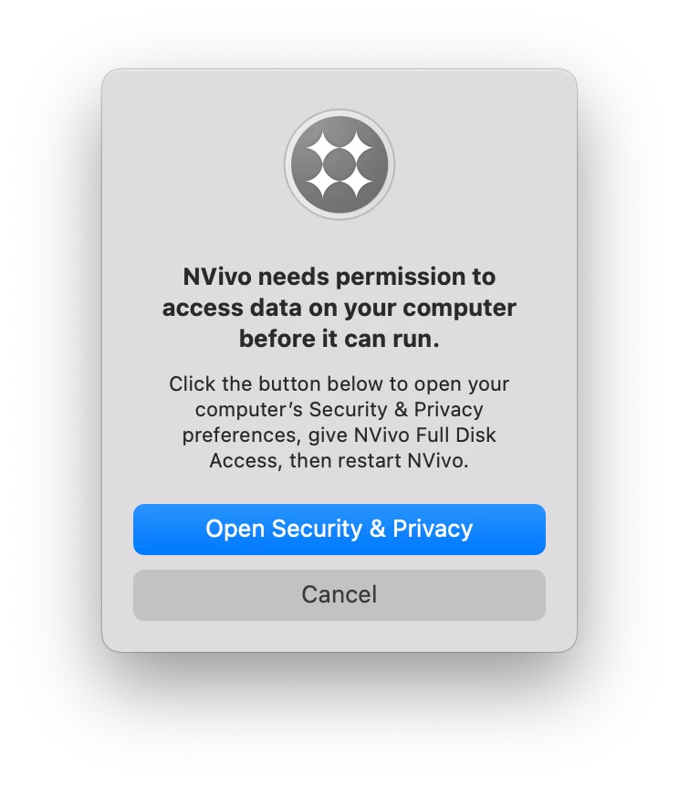

Hi,
I'm seeing an issue with NVivo 20.7.0 and even the previous version that I packaged - 20.6.2. The issue is that when I try and start NVivo it says:
NVivo needs permission to access data on your computer before it can run.
Click the button below to open your computers Security & Privacy preferences, give NVivo Full Disk Access, then restart NVivo
- I use a Configuration Profile to give NVivo full disk access.
- I only get this pop-up on M1 machines - not Intel ones
- For Intel machines, I've tested on Mac OS 11 and 12 - no issue. On Apple Silicon (M1) computers I've tested with Mac OS 12 and get the pop up.
- I tried unscoping the problem machines from the Configuration Profile and adding NVivo manually for Full Disk Access in System Preferences > Security & Privacey > Full Disk Access but no change and can't get NVivo to start
- I read this post https://forums.nvivobyqsr.com/topic/10209-i-have-given-nvivo-full-disk-access-but-it-still-will-not-open/ in the QSR User Forum and creating a zero byte file called CloudTabs.db in ~/Library/Safari/ and it solved the problem and NVivo starts fine just like on intel machines.
- I'm struggling to create an Automated fix to work around the issue because it seems like the ~/Library/Safari folder has a lot of protection from meddling and currently I haven't been able to do anything on the command line. This makes sense because the folder is for Safari and isn't meant to be tinkered with, not even with users who have root access.
e.g.
dep59767:~ root# /bin/mkdir /Users/itadmin/Library/Safari mkdir: /Users/itadmin/Library/Safari: Operation not permitted dep59767:~ root# su itadmin itadmin@dep59767 . % /bin/mkdir /Users/itadmin/Library/Safari mkdir: /Users/itadmin/Library/Safari: Operation not permitted
- I can't even get Composer to capture that file :(
Has anyone come across this issue and have you found something a bit better than getting the users to manually create the folder and drag it into the ~/Library/Safari folder  - e.g. a plist or setting file in NVivo that I could tweak to stop NVivo looking in that folder for the CloudTabs.db file?

Unfortunately whilst that will work on intel machines even with Monterey, when I try just that touch command (or the mkdir when Safari hasn't been used) as the user I get this on M1 machines
itadmin@dep59767 ~ % touch ~/Library/Safari/CloudTabs.db touch: /Users/itadmin/Library/Safari/CloudTabs.db: Operation not permitted itadmin@dep59767 ~ % touch /Users/itadmin/Library/Safari/CloudTabs.db touch: /Users/itadmin/Library/Safari/CloudTabs.db: Operation not permitted
Looks like we can step around this by giving Terminal Full Disk Access. Just had it work on an Intel, a VM on my Intel, and a physical M1.

PaulHazelden
  • Oct 10, 2022 9:10 AM UTC
In the Terminal you look like you are using root account. Try logging in as an administrator and using sudo rather than root. I know sounds daft, but when Apple changed the system around and locked out the System folder, they changed root access, and now for some things sudo does a better job.
dlondon
  • Oct 11, 2022 2:16 AM UTC
Unfortunately sudo doesn't do it either
I tried first removing ~/Library/Safari in Finder and then in terminal
itadmin@dep59767 ~ % sudo mkdir ~/Library/Safari Password: mkdir: /Users/itadmin/Library/Safari: Operation not permitted
Then I just opened Safari and that creates the folder
so then I tried making the zero byte file using touch in the Terminal
itadmin@dep59767 ~ % sudo touch ~/Library/Safari/CloudTabs.db touch: /Users/itadmin/Library/Safari/CloudTabs.db: Operation not permitted
But all these things can be achieved in Finder by the user.
PaulHazelden
  • Oct 11, 2022 8:37 AM UTC
If they can be done by the user, can they be done by script as the user?
If they can, create a script, and create a LaunchAgent to set the script off. Then when the user logs in the script will run. Use a test to see if the db file exists and then you can exit the script. LaunchAgent scripts always run as the User logging in.
bethjohnson
  • Oct 11, 2022 5:14 PM UTC
I'm using this snippet in a script to solve this problem. It runs from a script in a policy that is set to run once per user per computer at login:
# Find the logged-in user loggedInUser=$(stat -f%Su /dev/console) # Create the file that NVivo is "testing" touch /Users/$loggedInUser/Library/Safari/CloudTabs.db echo "The file has been created for NVivo to read."
 This has solved it for us on all of our lab computers.
This was a really poor decision on QSR's part -- adding their own access "check" and making it look like a PPPC profile will satisfy their check, but it won't.

Thanks Beth,
  • Oct 12, 2022 1:46 PM UTC
Thanks Beth,
dlondon
  • Oct 13, 2022 12:46 AM UTC
Thanks Gray - looks like that did the trick!
