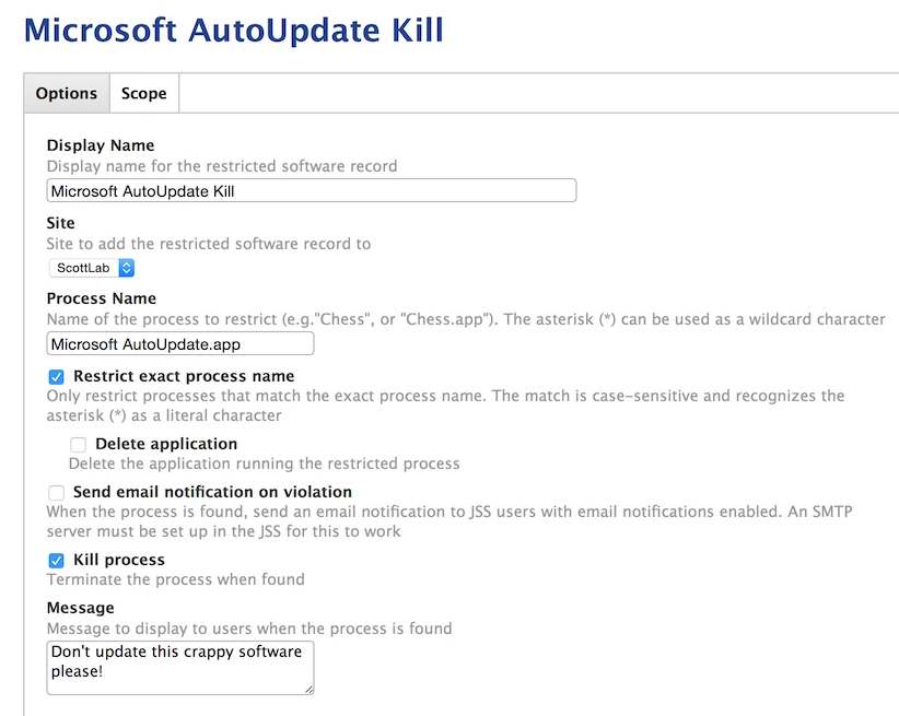

mm2270
  • May 14, 2015
@dgreening Yes! I recall running into that exact scenario about a year or more back. I'd completely forgotten about that though. We tried adding MS Auto Update.app into Restricted Software, but unfortunately it seems that the application tries to open or is accessed in some way in the background on launch of other Office applications, so the Restricted Software message was popping up for us even though it wasn't specifically launched. We had to quickly shut off the Restricted Software setting to avoid annoying everyone and incurring some wrath.
I wish I had an answer for how to get around that, but the only thing I can suggest is to not make it come up with a message. Just kill it silently and no message. It will still stop it from running, but its going to kick in on every Office application launch - so annoying!
You 'd also want to make sure NOT to check to send emails on violations, unless you like getting spammed by your JSS!

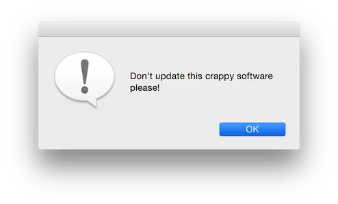

I learned the hard way too about how often that process is opened. @boettchs @dgreening I enabled the same software restriction process name "Microsoft AutoUpdate.app", along with a message to the user informing them to "don't update to 14.5.0..." and scoped it to devices with 10.10.
Turns out the warning message was posted over the lock screen saver and multiple times to the end users. That resulted in extra calls to the help desk. Now I just have it quit the app and the message field is blank.
scottb
  • May 14, 2015
Just turn off the message. It's fine now...
Or rather, take the text out of the message portion of the Restriction setup.
