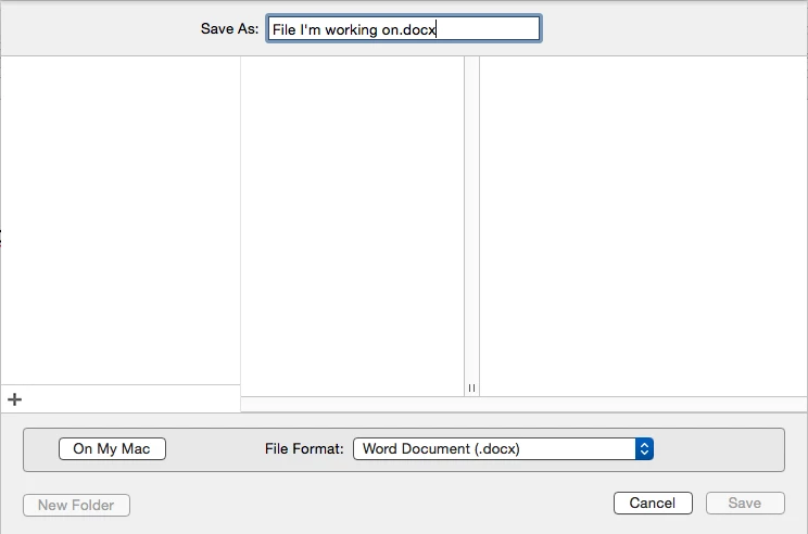

It is recorded in ~/Library/Group Containers/UBF8T346G9.Office/MicrosoftRegistrationDB.reg file.
1) Click "On My Mac" and Save a document ~/Documents folder and also Open a document for your computer so it will remember "On My Mac" setting.
2) Create a .dmg of ~/Library/Group Containers/UBF8T346G9.Office/MicrosoftRegistrationDB.reg using Composer and then push it with FEU and FUT ticked so all existing users and User Template will get it.

So, I have been digging into the MicrosoftRegistrationDB.reg and have found the entry that controls this setting. If I use a GUI SQLite editor (DB Browser for SQLite) , I can successfully change the value and get consistent results.
Details:
Table: HKEY_CURRENT_USERS_values
node_id: 485
type: 4
value: 0 -or- 1
By default the value is 0, this will cause show the "Online Locations" as the default save location.
If you change the value to 1 it will show "On My Mac" as the default save location.
Does anyone know how we can script this change?
