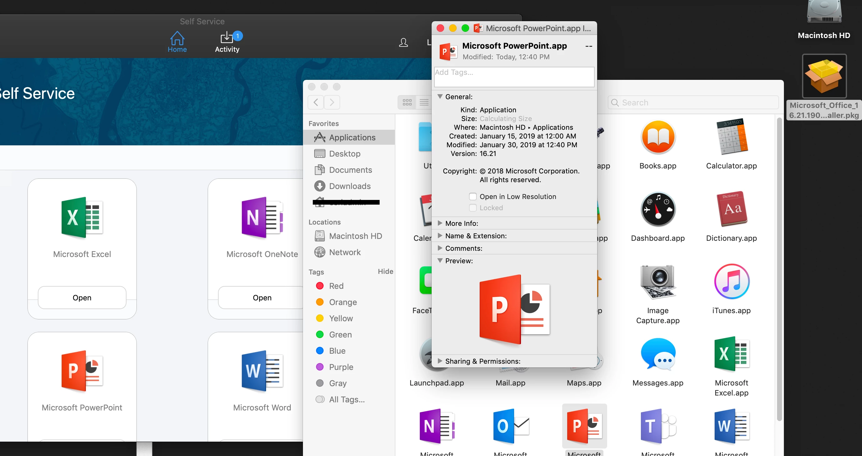

If I can extend on this... in our setup, when I added MAS 365 to Self Service, the button just went to "open", like it knew it was already installed. But its the pgk installed version with MAU. Will the app store take over updating it?
screen shot below, used that pkg to install office, MAS Office is in self service with "open" and MAU is installed still.

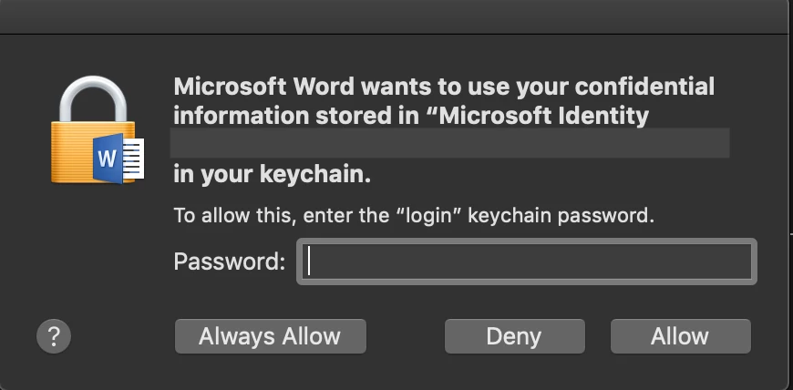

Thought this might be a good place to ask. Has anyone else seen the numerous prompts for you password when starting an O365 app for the first time? Is there a work around for it?

@landon_Starr Yeah, when migrating this occurs. Search for pbowden his nukeofkeychain script
  • February 1, 2019
@landon_Starr
Yep. Multiple times. Not sure why. I am trying to figure that out. I wonder if it was to to do with Privacy Preference Policy Control....?
  • February 4, 2019
Thanks @txhaflaire for pointing me to that bad boy! So with the O365 apps being deployed through VPP, what's the best way to run it since they're getting pulled down from the app store.
  • February 4, 2019
Hey guys, has anyone the same issue if you try to install the apps via Self Service (VPP) and for example "Word" didn't download/ installed, just an icon for forwarding the user to the App Store. If I click again on install Word (Self Service) it works, but the user has to accept many keychain notifications with my own password. Any ideas?
  • February 4, 2019
@Florian.Proft I asked the same question a few days ago, and the answer is sitting right above your question :)
There's a script to nuke those keychain prompts, I'm just looking into what's the best way to push it out now that the apps are VPP.

@Florian Yeah you have to nuke the users his keychain, we mean some of the keychain items.
@landon_Starr Check out @daz_wallace his blog for more information https://dazwallace.wordpress.com/2019/01/30/migrating-microsoft-office-suite-to-mas-deployment/
