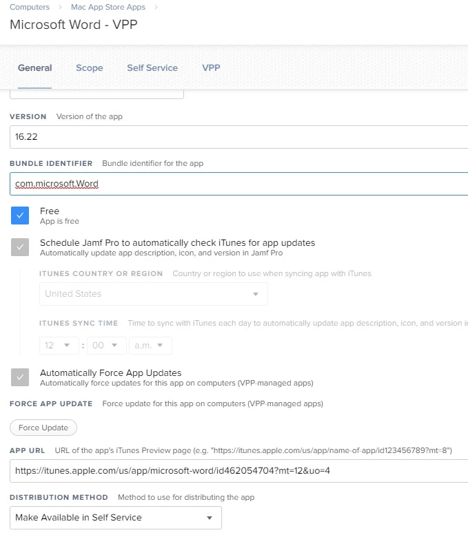

@aaelic24 I mean that we have set to check every XX:XX for Mac App Store updates and force them via Settings -> Computer Management - App Updates:
@pbowden Users with app in launch state are not receiving any slipstream prompt oi. But now u clicked the button to force update on App Updates section my apps are being updated. Maybe it is because i have set the update time on 12:00 PM, so i have now set that to 01:00 PM and that is a moment when most clients are active and online, so will see how that works out.
Okay, nothing good happened, the icons appeared as they get updated but bad results, all apps are closed before pushin updates.
