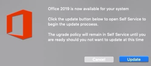

Example to complete our Office 2019 upgrade I use the below code and the user sees the below clicking Update will open Self Service in this case but you can setup however you want and for example have the button call a specific policy with sudo jamf policy -event #customeventname
jamfHelper="/Library/Application Support/JAMF/bin/jamfHelper.app/Contents/MacOS/jamfHelper"
windowType="hud"
description="Office 2019 is now available for your system
Click the update button below to open Self Service to begin the update procoess.
The ugrade policy will remain in Self Service until you are ready should you not want to update at this time
button1="Update"
button2="Cancel"
icon="/Library/<yourdatalocation><yourfile.icns>"
title="Title"
alignDescription="left"
alignHeading="center"
defaultButton="1"
cancelButton="2"
userChoice=$("$jamfHelper" -windowType "$windowType" -lockHUD -title "$title" -defaultButton "$defaultButton" -cancelButton "$cancelButton" -icon "$icon" -description "$description" -alignDescription "$alignDescription" -alignHeading "$alignHeading" -button1 "$button1" -button2 "$button2")
if [ "$userChoice" == "0" ]; then
    echo "User clicked Update; Now opening Self Service."
    sudo -u $(ls -l /dev/console | awk '{print $3}') open /Applications/Self Service.app
elif [ "$userChoice" == "2" ]; then
    echo "User clicked Cancel or timeout was reached; now exiting."
Thanks for the input. The prompt you show is actually great, but would need to build in some option to ask for office Applications or defer option. But my scripting is by far that not that skilles. Have really searched a lot to find something usable for Office instead just showing the standard notfication the appears shortly that users dont really notice
