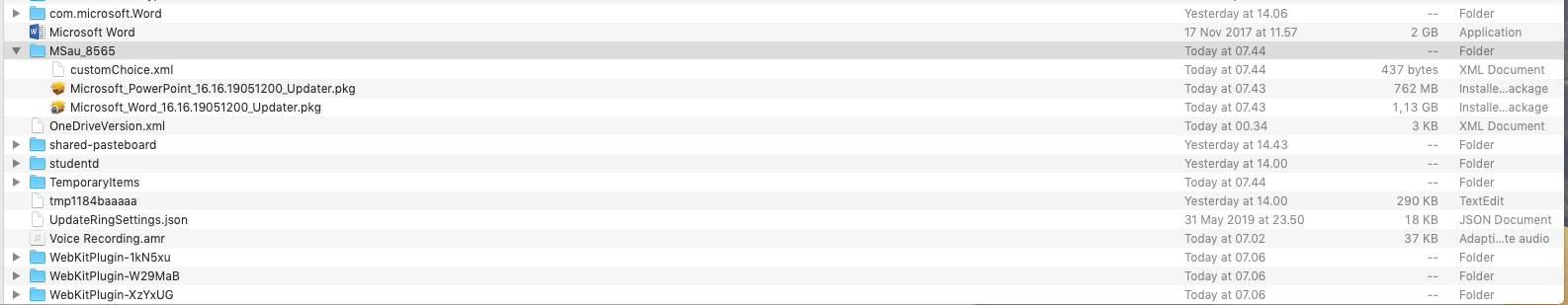

I hope I can get a little script help. I don´t think it should be a big job and propably afterwards also something that other could use
The issue is that when office updates are pending they are stored in $TMPDIR/MSau*
(the updates are staying there until they are installed which require a restart of the app). So if someone has an update for outlook pending and don´t restart, I can send out a prompt requesting them to restart(the prompt I can do on my own)
So I want create a script that first set the $TMPDIR - as the $TMPDIR is different from each client
Afterwards in the script should check if there is a MSau_xxxx/microsoft_powerpoint* (take powerpoint as example)
I can than base a EA on each office product, and know when I have to send out a message to the user if they have this EA and that fx powerpoint must be restartet.

Running the script manually it works fine and rapport correct back, but when added it as EA it seems not to find anything on the client and rapport it is empty (yes have tried a recon first:) )

@jameson Jamf Pro might not like the new lines in the output. I also found that sometimes the update packages look like "Word_16.23.19030902_to_16.25.19051201_Delta.pkg", so I accounted for that. Try this:

No - still not working. If no updates are there it rapports none - so somehow it must be the naming etc since nothing is showed when updates are there
