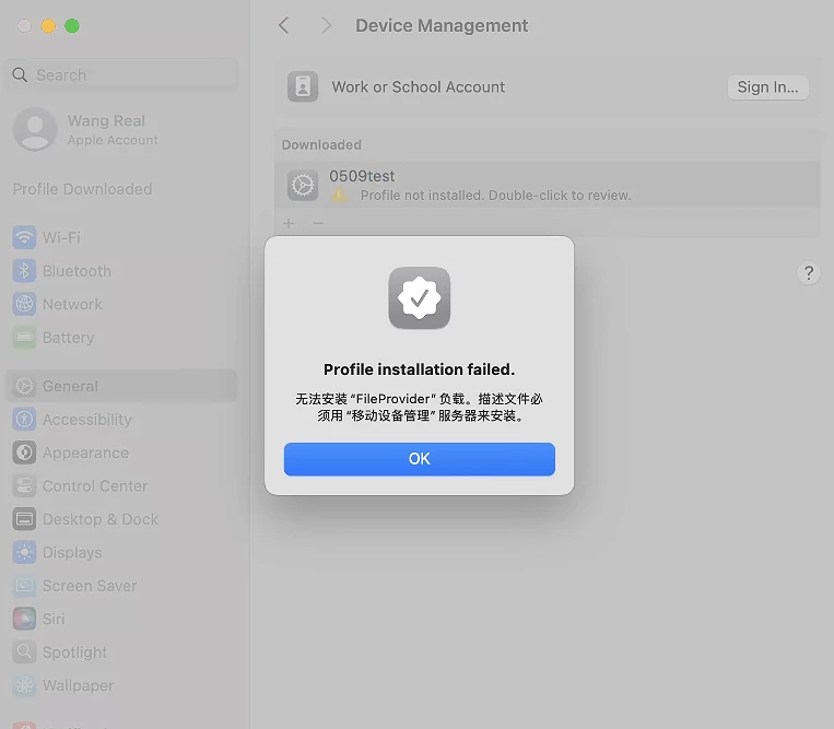

Shwan
After upgrading to macOS 15, all devices are unable to install offline configuration files (.mobileconfig or .profile). The system displays the error: "Could not install 'FileProvider' payload. Configuration profiles must be installed via a Mobile Device Management (MDM) server." Has anyone else encountered this issue? Any solutions would be greatly appreciated. Thank you very much!

sdagley
  • May 9, 2025 3:07 AM UTC
@Shwan Are you not using MDM for your Macs? (Looks like it from the image in your post) Apple docs for the com.apple.fileproviderd (https://developer.apple.com/documentation/devicemanagement/fileprovider) lists both "Allow Manual Install" and "Requires User-Approved MDM" as supported for macOS but those seem mutually exclusive. It's possible Apple changed the behavior for macOS 15 to disable manual install but failed to update the docs properly.

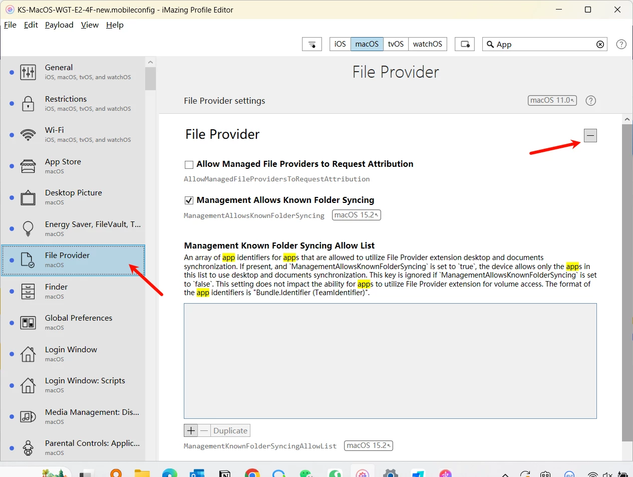

Shwan
  • May 14, 2025 3:29 AM UTC
I think I’ve identified the cause of the error. By opening the profile downloaded from Jamf with iMazing and removing the ​File Provider​ payload, the installation works perfectly now. Thank you all for your help—I really appreciate it! 🙌
