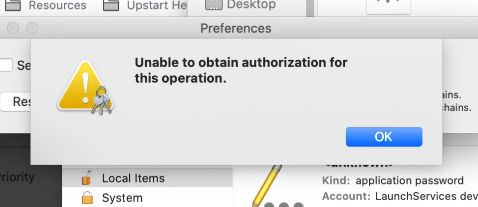

@caine.horr I've reached out to okta support and they suggested resetting default keychain. Upon doing that, users get this
I tried having them repair their disk via disk utility and trying a reset again and it does not work still. Have you ever seen this before?
