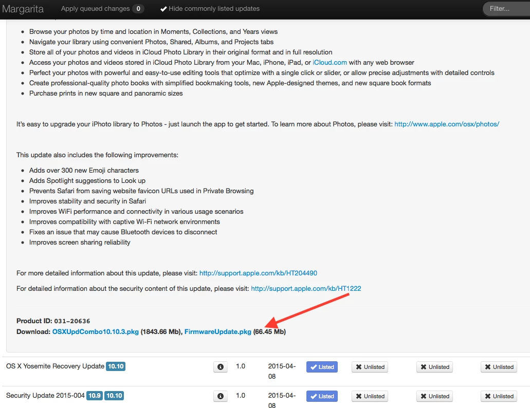

Thar be a mysterious FirmwareUpdate.pkg that requires further investigation. It certainly did something on my rMMP (mid 2014)

And yet another firmware update delivered in / with an OS X updater which will give @Banks something to pull apart again.

I wonder if this can result from a Mac that needs a firmware update and installs the 10.10.3 update from the MAS. Apple may be issuing specific updates for Macs that needs a fw update along with the 10.10.3 updater rolled together. Not the first time they've done this as we know. I think its a really bad practice to roll these together, so if that's what they are doing, I'm going to give Apple a piece of my mind - not that it will matter much other than making me feel a little better.

The firmware update is for more recent Macs, to prevent against the Thunderstrike vulnerability, I'm pretty sure.
