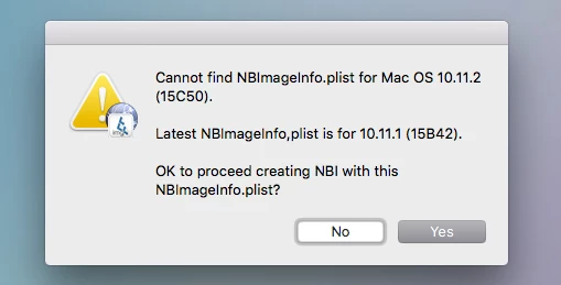

@bentoms How's AutoCasperNBI looking? I see it gave me a warning when genrating a 10.11.2 (15C50) .nbi image. I continued on with the build process, but I havent tested yet.

@dstranathan let me know.. it does look like 10.11.2 contains the SupportedModelProperties array in the platformSupport.plist.
So i can revert the fix i put in for it not being there, as per this
bentoms
Forum|alt.badge.img+35
  • December 9, 2015
@dstranathan Let me know!
Not had a chance to update the NBImageifo.plists yet

Can people please test 1.3.2: from here
Please log issues &/or review the open ones: here.
dstranathan
Forum|alt.badge.img+19
  • December 9, 2015
Worked for me. No errors or warnings.
Thank you, sir.
  • December 10, 2015
Yeah the new version worked great for me! Thanks for the quick update!
bentoms
  • December 10, 2015
@dstranathan & @harperwr Thanks both!
Just released 1.3.2 :)
Available here & pre-1.3.2 should prompt to update too.
