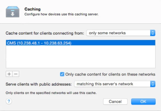

Second, Are you under the same public IP as another person using a caching server? We had this problem and the other site with the caching server was behind another firewall which made things not go so well. We set ours up like below to make sure it used ours:
Third, enabling the LogClientIdentity option is helpful. It shows every connection to the caching service in the caching server log. This should show if it is making the connection at all.
sudo serveradmin settings caching:LogClientIdentity = true
