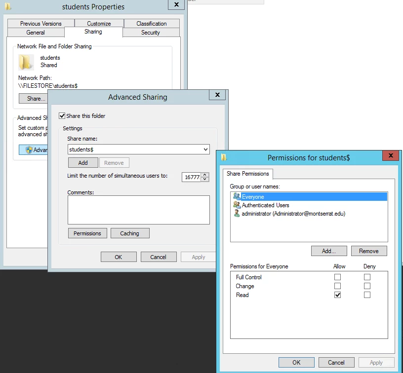

-- Firstly, modify the Share level (SMB) Permissions for the Share (default shown in TechNote Table 7.13)
Right-Click on the share > Properties > Advanced sharing > Permissions > Add...
"Add" sharing permissions to allow Everyone: Read

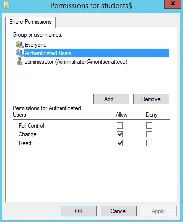

Authenticated Users: Change, Read

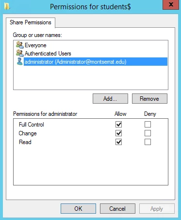

Administrators: Full Control, Change, Read
If you have any file admin groups that need to modify ACLS, you should add them here with the same permissions as Administrators above.

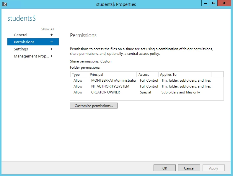

-- Next, modify the "Creator Owner" permissions on the Share (default shown in TechNote Table 7.12)
Right-Click on the share > Properties > Security...
Creator Owner: Subfolders and files only - everything EXCEPT: Full Control, Change permissions, Take ownership
These settings will prevent normal users from modifying ACLs, nipping the troublesome ACLs in the bud.

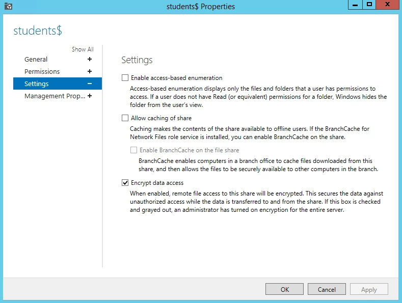

To get things to work I forced smb1 on the clients and disabled Access Based Enumeration on the server. This seemed to work for awhile, but the "everyone, deny, delete" permissions kept coming back so I've been experimenting with permissions by following @Swift recommendations:

SMB3 with Windows Server 2012 R2 seems to be working on 10.10.3.
Share settings:
Everyone: Read
Security (NTFS) settings:
SYSTEM: Full Control (Applies to "This folder, subfolders, and files")
Local or Domain Administrator: Full Control (Applies to "This folder, subfolders, and files")
CREATOR OWNER: Everything except Full Control, Change permissions, and Take ownership (Applies to "Subfolders and files only")
On Server Manager, go to File and Storage Services > Shares
Uncheck "Allow caching of share"
Check "Encrypt data access"
Despite not letting Creator Owner have full control, the defined user account ends up getting full control anyways. I think the idea for setting restrictions on the share permissions is to circumvent full control. Windows admins typically prefer to set everyone at full control and then have everything secured at the NTFS level. That method just doesn't seem to work well when os x clients are involved. Securing authenticated users at the share level might prevent them from having full control or weird ACL issues.
"Share permissions and NTFS permissions are independent in the sense that neither changes the other. The final access permissions on a shared folder are determined by taking into consideration both the share permission and the NTFS permission entries. The more restrictive permissions are then applied."
In our case, the share settings actually are the more restrictive permissions for our users.
We'll be testing with this setup. It's encouraging to see that we can actually use SMB3 now. Is anyone else using SMB3 with Windows Server 2012 R2 successfully?
Note: I still have Access Based Enumeration disabled.

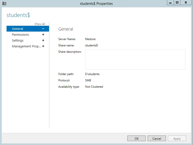

The following are screen shots of the configuration, if helpful.
