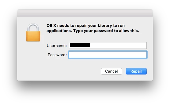

Hello all,
We have been getting this error since upgrading to Mavericks. "OS X needs to repair your Library to run applications. Type an Administrator's name and password to allow this". This happens on a per user base. A user can login and get this error and logoff and get no error. It seems "random" but we know its not. Just cant seem to connect the dots.
If you navigate to ~/library. It says "The operation can't be completed because the item can't be found". But if you navigate through Computer-->Macintosh HD-->Users everything is there, and has full permissions.
Things we have tried that have failed.
  1. Fix disc permissions
  2. Repaired Keychain
  3. Software update to OS X 10.9.2
  4. Deleted Login Keychain via script
  5. Created a folder in ~/Library/User/keychain @Postimage
  6. sudo update_dyld_shared_cache -root / @Login
  7. Disabling Keychain Update via script
We are using Active Directory
Our Users are Managed, Mobile
Any help would be greatly appreciated

We have seen this where we have set mobile accounts required, and do not ask, but the user has somehow chosen Do not Create mobile account, and checked the don't ask again box, maybe before the settings took hold? AD environment, we always use mobile accounts.
To fix, I run the following line against the account, replacing USERNAME with the affected user, while they are logged out.
/System/Library/CoreServices/ManagedClient.app/Contents/Resources/createmobileaccount -n USERNAME -v
Run as root if using ARD.
I also use this as a script in the JSS that uses $4 and I push that using Remote.
@stevewood
Bingo. Solved my same issue on Monday
Thanks

Was wondering if there's a permanent fix for this issue as we are getting this error on all Yosemite 10.10.5 client. Our staff are logging in with their OD network accounts. As soon as this error comes up, users are no longer able to save, find files or launch some applications.It also asks users to put admin credentials which is not helping at all..So annoying..
Our temp fix was either to logout the user account and reboot the machine and let the user login again until then the error comes back again..
<text deleted>
@stevewood - thanks! this worked perfectly.

This issue just surfaced on our campus on Macs running 10.11.
We have our Mac computers bound to Active Directory via the Directory Utility and have it set to create a mobile account upon login. Yesterday, I delivered a computer to one of our users -- and when she logged in, she was greeted with the "OS X need to repair your library..." message. I thought this was strange because I had tested this particular machine with 2 different AD user accounts prior to delivery to be sure that it was working. Somehow, a corrupted template was applied to her user folder and she wasn't able to access any folders within her home folder, as well as not being able to run applications. Changing the permissions on the folders by right clicking the folders and using get info didn't work either.
I also attempted to use the script listed above, but unfortunately that hasn't resolved the issue either. Still trying to figure out what is causing the issue, as it's not consistent among our users. It only seems to affect a small number of people with newly imaged computers. So far, we haven't encountered the issue with those who have upgraded from 10.10.
@cesposito
I just had this happen with a local user account.
Ressing the account ACLs with the Reset Password utility from the Recovery Partition didn't work.
So I tried one last thing before just rebuilding the user's account and copying around data.
I deleted the home folder, selecting the "Don't change the home folder" option.
I then renamed the just-deleted home folder to the original name with
sudo mv "username (Deleted)" username
I then recreated the account with the original name & credentials. OS X will use an existing home folder if the names match. Some versions of OS X will ask whether to use the folder, others just use it.
This fixed things right up.
