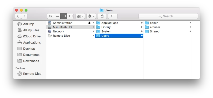

If you navigate to ~/library. It says "The operation can't be completed because the item can't be found". But if you navigate through Computer-->Macintosh HD-->Users everything is there, and has full permissions.

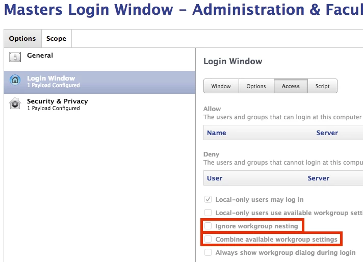

The configuration profile that configured our login window had the “Combine available workgroup settings” checkbox unchecked. Pushing out an updated profile and changing just this setting stopped the Library repair message from appearing. Ultimately, this appeared to be a workgroup setting issue with the account I was using (my own), as I am a part of many different groups and nested groups.

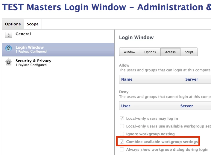

I had a hunch this might be something profile-related and checked our configuration profiles. I noted in the Login Window payload under Access that neither the Ignore workgroup nesting or Combine available workgroup settings were checked.
To test, I cloned this profile, scoped it to our test machine, and checked the Ignore workgroup nesting while leaving the combine setting unchecked. This did not stop the message from appearing for my AD account nor created a cached mobile account.
Then I tried checking the “Combine available workgroup settings” and leaving the ignore nesting setting unchecked. Unlike my first test, this change stopped the Library repair message from appearing and successfully created a mobile account for my own AD user!
We are currently still on 10.11.6 and this was not previously an issue.
So it appears that for us this was a niche-case workgroup issue with an AD account that was part of many groups and/or nested groups.
