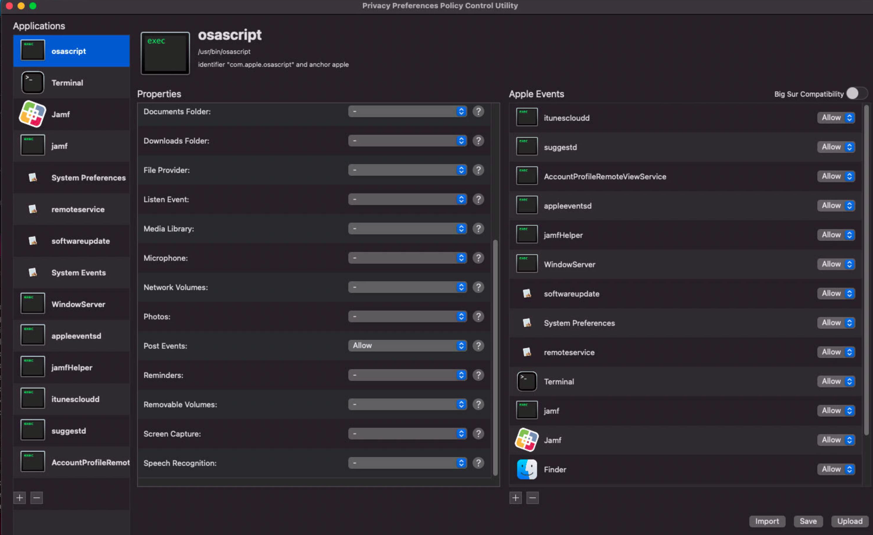

So for the M1 machines I am trying to initiate a GUI update and while it works if i manually accept the Terminal permissions prompt, it wont work in the script.
Here is what is known.
  1. It works with applescript AND as part of the shell script if i accept the following notice
  2. I had the TCC stream running before and during the whole time i ran the script, thus ideally catching who the requester was so that i can add that entry to the PPPC profile but the end result is the same
  3. I had to make in big sur cuz it was asking for privateframework locations that were not on my Catalina machine
  4. I do a direct upload from PPPC utility instead of saving it then uploading to JSS manually, hoping to minimize translation issues
  5. Here is the excerpt of the code that works post acceptance of number 1
guiSOFTWAREupdate() { launchctl asuser ${currentUSERid} /usr/bin/osascript <<EOD tell application "System Preferences" activate tell application "System Events" tell process "System Preferences" set frontmost to true end tell end tell if exists window "Software Update" then tell window "Software Update" to if it is miniaturized then set miniaturized to false else set the current pane to pane id "com.apple.preferences.softwareupdate" end if tell application "System Events" tell process "System Preferences" repeat until (exists window "Software Update" of application process "System Preferences" of application "System Events") delay 1 end repeat if (exists static text "Checking for updates…" of group 1 of window "Software Update" of application process "System Preferences" of application "System Events") then repeat set itExists to exists busy indicator 1 of group 1 of window "Software Update" of application process "System Preferences" of application "System Events" if itExists then delay 1 else exit repeat end if end repeat end if if (exists button "Restart Now" of group 1 of window "Software Update" of application process "System Preferences" of application "System Events") then click button "Restart Now" of group 1 of window "Software Update" of application process "System Preferences" of application "System Events" set myRESULT to "Restart Now" else if (exists button "Upgrade Now" of group 1 of window "Software Update" of application process "System Preferences" of application "System Events") then set myRESULT to "Upgrade Now" else if (exists button "More info…" of group 1 of window "Software Update" of application process "System Preferences" of application "System Events") then click button "More info…" of group 1 of window "Software Update" of application process "System Preferences" of application "System Events" if (exists button "Install Now" of sheet 1 of window "Software Update" of application process "System Preferences" of application "System Events") then click button "Install Now" of sheet 1 of window "Software Update" of application process "System Preferences" of application "System Events" set myRESULT to "Install Now" end if end if set frontmost to true return myRESULT end tell end tell end tell EOD echo "$?" }
  • I have essentially gone through looked at all the TCC stream logs to see what I may be missing but I cant find anything... (patebin link to stream: https://pastebin.com/KVtQqizE)
  • I went all out trying to add exceptions too, see below
Looking to see if you guys have any insight to this matter as I am super stumped now ( @mm2270 for visibility)
