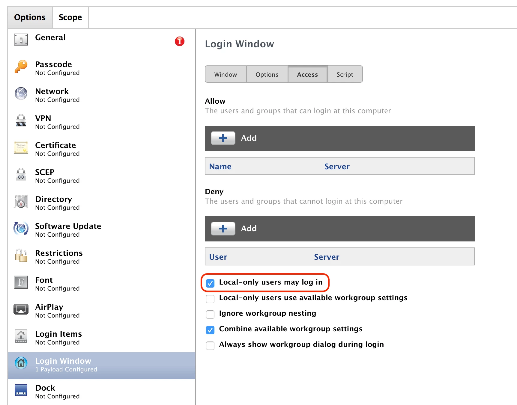

  • August 1, 2017
I've been looking all over the JSS to find out where the 'Local-only users may log in' is so I can enable it. Can someone please point me in the right direction?
Thanks!
davidacland
  • August 1, 2017
@ctarbox it's in the Login Window payload for macOS configuration profiles:
  • August 1, 2017
NVM. I found it!
  • August 1, 2017
Yes, I just figured out where it was. Thanks for the quick reply, and now the location is posted for others.
