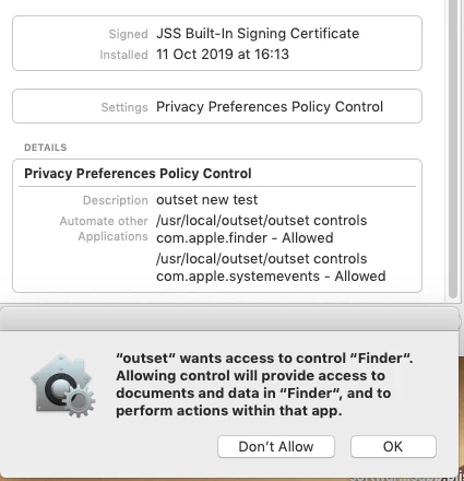

I'm having real problems getting PPPC to work with outset.
I've followed guides here: https://carlashley.com/2018/09/23/code-signing-scripts-for-pppc-whitelisting/
Everything seems good/signed on my outset script, and I've managed to package it up and deploy it still signed. Various commands on terminal verify this.
It seems to be the Configuration Profile that I can't get to work correctly.
  • I used the PPPC Utility to make sure I was creating the settings correctly.
  • I allowed FINDER
  • I allowed SYSTEM EVENTS
Still I am prompted - am I missing something?

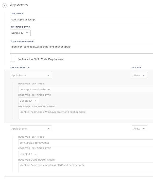

1) Looking at the first three RESP entries, it looks like the responsible application (Terminal) is accessing OsaScript and requesting WindowServer and appleeventsd.
2) I therefore created a PPPC (See image) for osascript to allow both WindowServer and appleeventsd, but the prompt still appears.
Am I misunderstanding what needs to be created in the PPPC?

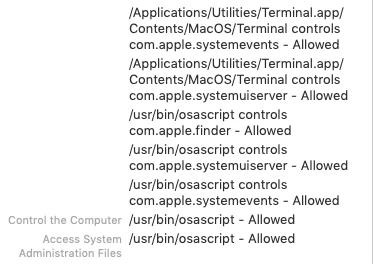

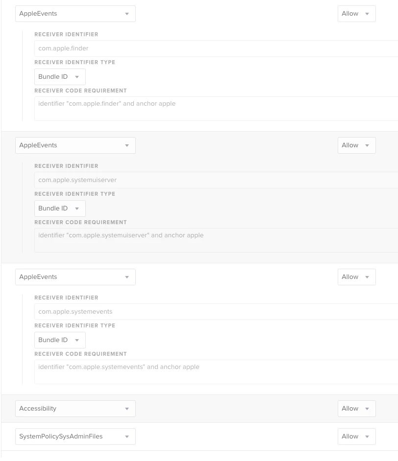

@CCNapier Try adding the following to your osascript PPPC, I believe you need finder when mounting network shares.

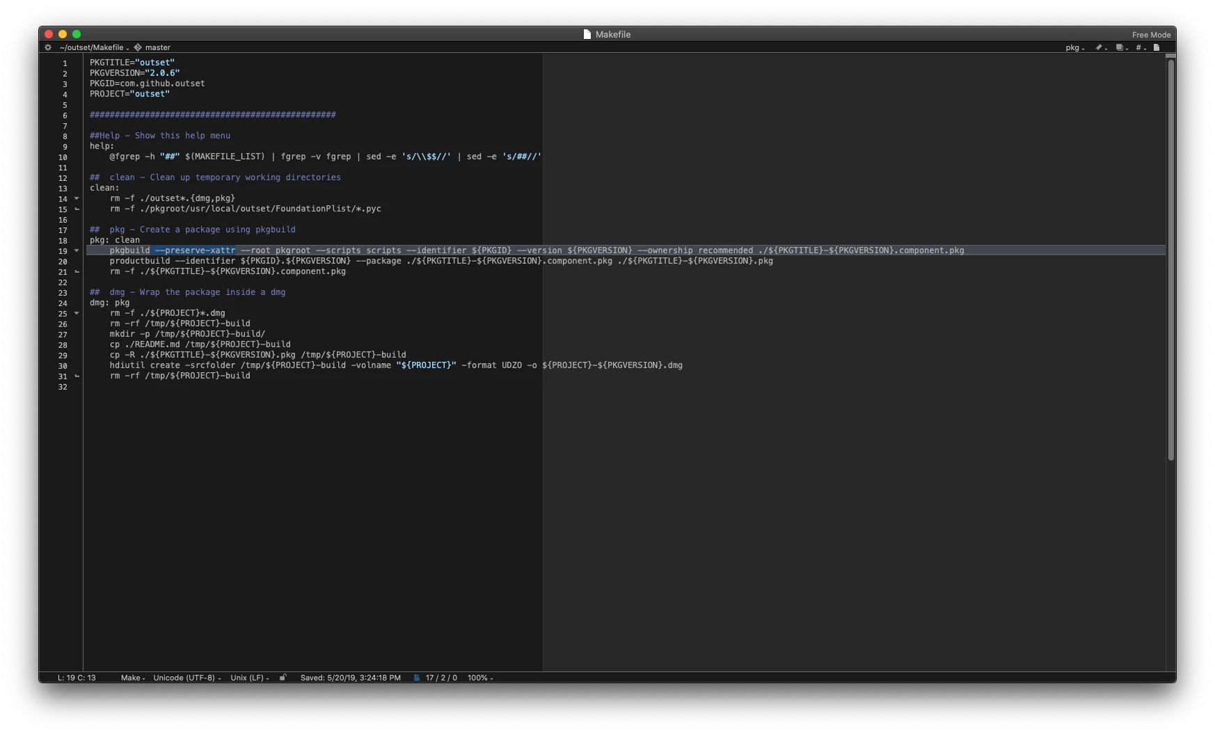

I assume your script is in one of the outset folders, how did you package it? did you use pkgbuild or Packager, did you make sure you followed the blog post and you codesign outset with a valid apple dev certificate and you preserve the attributes?
@Eigger Outset is signed OK.

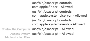

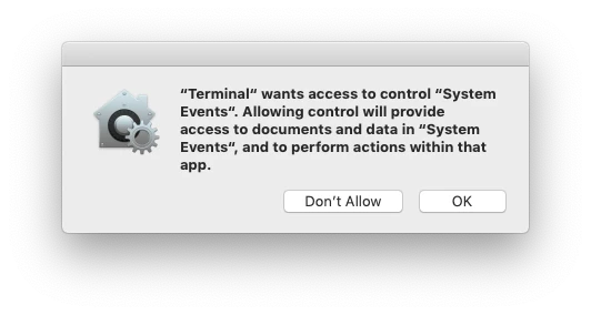

I applied the settings to an osascript PPPC:
As an experiment I'm attempting to run a simple set of commands from Terminal.
sudo tccutil reset All osascript -e 'tell app "System Events" to display dialog "Hello World"'
Problem still shows:
Should your osascript PPPC settings now allow me to run it from terminal?
@CCNapier Do you have PPPC for Terminal to allow "System Events" for your experiment?
Hi @Eigger Yes I do have Terminal to allow "System Events" (tried using path and bundleID methods):
TCC says the following:
Filtering the log data using "subsystem == "com.apple.TCC" AND composedMessage BEGINSWITH "AttributionChain""
Timestamp                       Thread     Type        Activity             PID    TTL
2019-11-04 10:02:33.136226+0000 0x1cfa36   Info        0x14899d             316    0    tccd: [com.apple.TCC:access] AttributionChain: RESP:{ID: com.apple.Terminal, PID[1128], auid: 2067712324, euid: 2067712324, responsible path: '/Applications/Utilities/Terminal.app/Contents/MacOS/Terminal', binary path: '/Applications/Utilities/Terminal.app/Contents/MacOS/Terminal'}, ACC:{ID: com.apple.osascript, PID[48970], auid: 2067712324, euid: 2067712324, binary path: '/usr/bin/osascript'}, REQ:{ID: com.apple.WindowServer, PID[280], auid: 88, euid: 88, binary path: '/System/Library/PrivateFrameworks/SkyLight.framework/Versions/A/Resources/WindowServer'}
2019-11-04 10:02:33.146951+0000 0x1cf9bd   Info        0x0                  316    0    tccd: [com.apple.TCC:access] AttributionChain: RESP:{ID: com.apple.Terminal, PID[1128], auid: 2067712324, euid: 2067712324, responsible path: '/Applications/Utilities/Terminal.app/Contents/MacOS/Terminal', binary path: '/Applications/Utilities/Terminal.app/Contents/MacOS/Terminal'}, ACC:{ID: com.apple.osascript, PID[48970], auid: 2067712324, euid: 2067712324, binary path: '/usr/bin/osascript'}, REQ:{ID: com.apple.appleeventsd, PID[89], auid: 55, euid: 55, binary path: '/System/Library/CoreServices/appleeventsd'}
2019-11-04 10:02:33.147662+0000 0x1cf9bd   Info        0x0                  316    0    tccd: [com.apple.TCC:access] AttributionChain: RESP:{ID: com.apple.Terminal, PID[1128], auid: 2067712324, euid: 2067712324, responsible path: '/Applications/Utilities/Terminal.app/Contents/MacOS/Terminal', binary path: '/Applications/Utilities/Terminal.app/Contents/MacOS/Terminal'}, ACC:{ID: com.apple.osascript, PID[48970], auid: 2067712324, euid: 2067712324, binary path: '/usr/bin/osascript'}, REQ:{ID: com.apple.appleeventsd, PID[89], auid: 55, euid: 55, binary path: '/System/Library/CoreServices/appleeventsd'}
2019-11-04 10:02:33.181324+0000 0x1cfa27   Info        0x149f50             841    0    tccd: [com.apple.TCC:access] AttributionChain: ACC:{ID: com.apple.systemevents, PID[48936], auid: 2067712324, euid: 2067712324, binary path: '/System/Library/CoreServices/System Events.app/Contents/MacOS/System Events'}, REQ:{ID: com.apple.systemevents, PID[48936], auid: 2067712324, euid: 2067712324, binary path: '/System/Library/CoreServices/System Events.app/Contents/MacOS/System Events'}
In fact, I have tried to completely replicate what's in https://carlashley.com/2018/09/06/reading-tcc-logs-in-macos/
I even tried using his exact code for creating the profile (albeit I had to modify some switches as they appear to be updated in the latest version he released) and it STILL prompted!!
./tccprofile.py --appleevents /Applications/Utilities/Terminal.app,/System/Library/CoreServices/System Events.app --allow --payload-description="Whitelist Terminal to allow AppleEvents sent from commands run in Terminal" --payload-identifier="com.github.carlashley" --payload-name="Terminal App AppleEvents Whitelist" --payload-org="My Great Company" --payload-version=1 -o Terminal_AppleEvents.mobileconfig
What the heck is going on??
