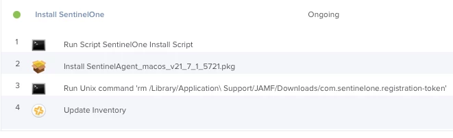

Hi All,
Having an issue where if I upload a new package in JAMF admin and create and deploy a policy through JAMF Pro it downloads and installs the package the first time, but if it fails or if I need to rerun it will fail every time with the below errors, If I rename the package and upload it and attach to the policy it will download again the first time but then fail again. Im at a loss as to what the issue is here.
