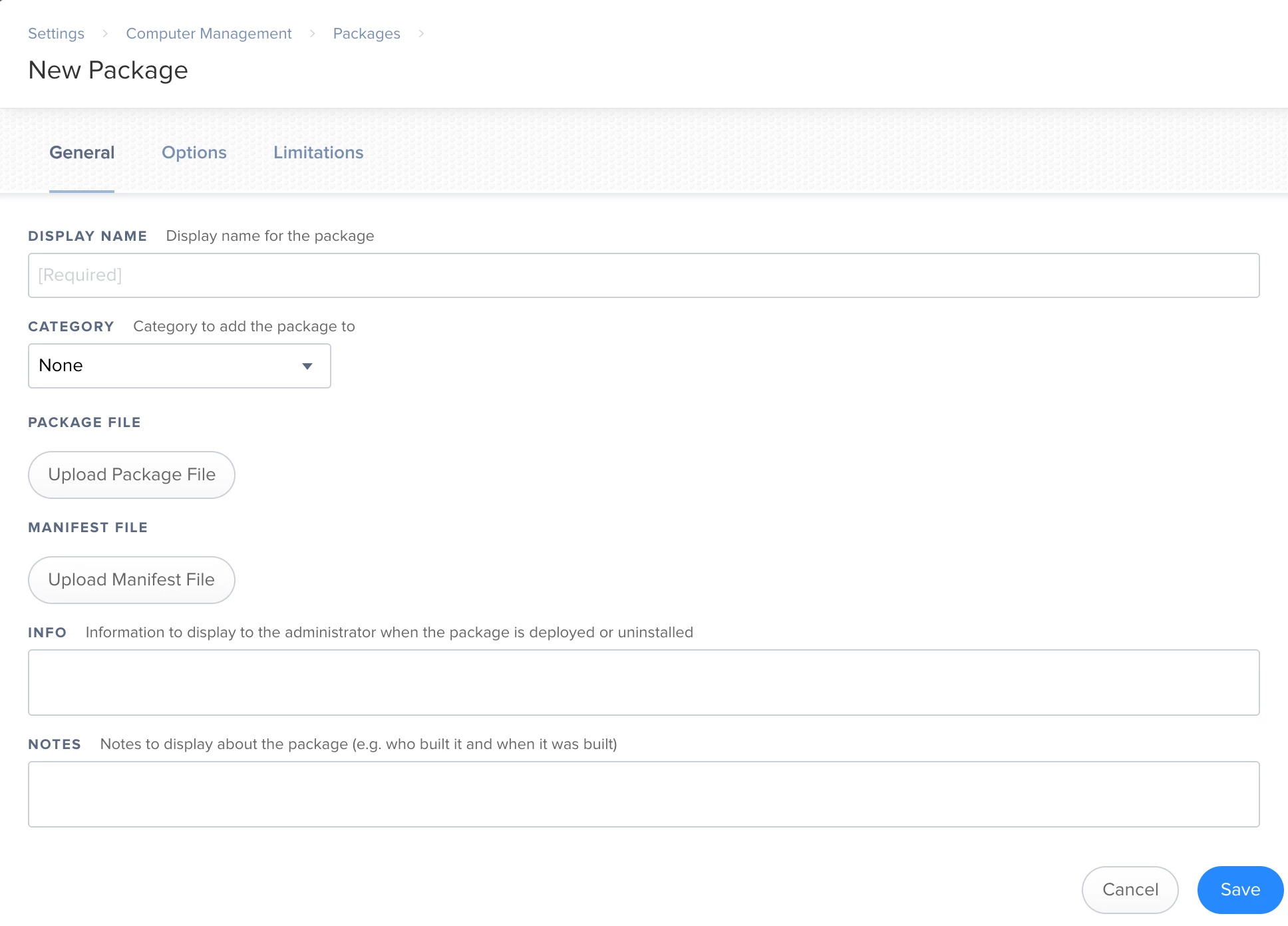

Have you tried to upload .pkg file through JSS, Settings > Computer Management > Packages > New

@rfadul I tried both in Safari and Chrome to upload the pkg and Chrome just sits there while in Safari I get the message "Package failed to upload" in red right below the "Choose file" button. This is a .PKG that I generated via the Adobe CC Packager. The corresponded "uninstaller.pkg" uploads without issue. This is the first time I've ever experienced this issue.
