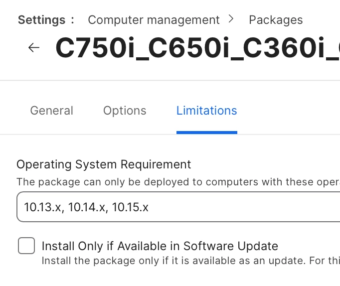

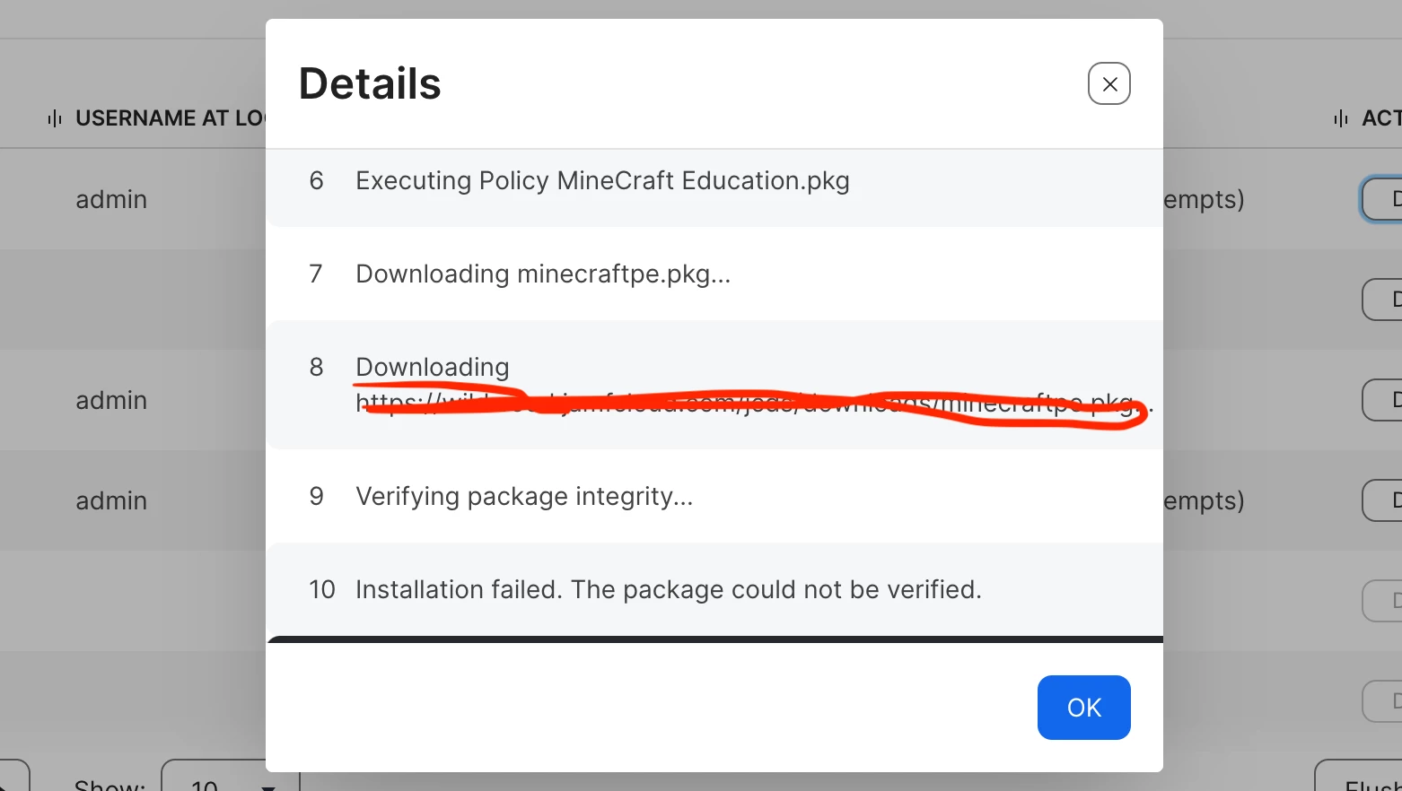

I created a package using jamf composer, These are the error messages I get when trying to install. For some reasons the package install works on newer devices (2020 MBAs) and failing on older devices (2017 MBAs)

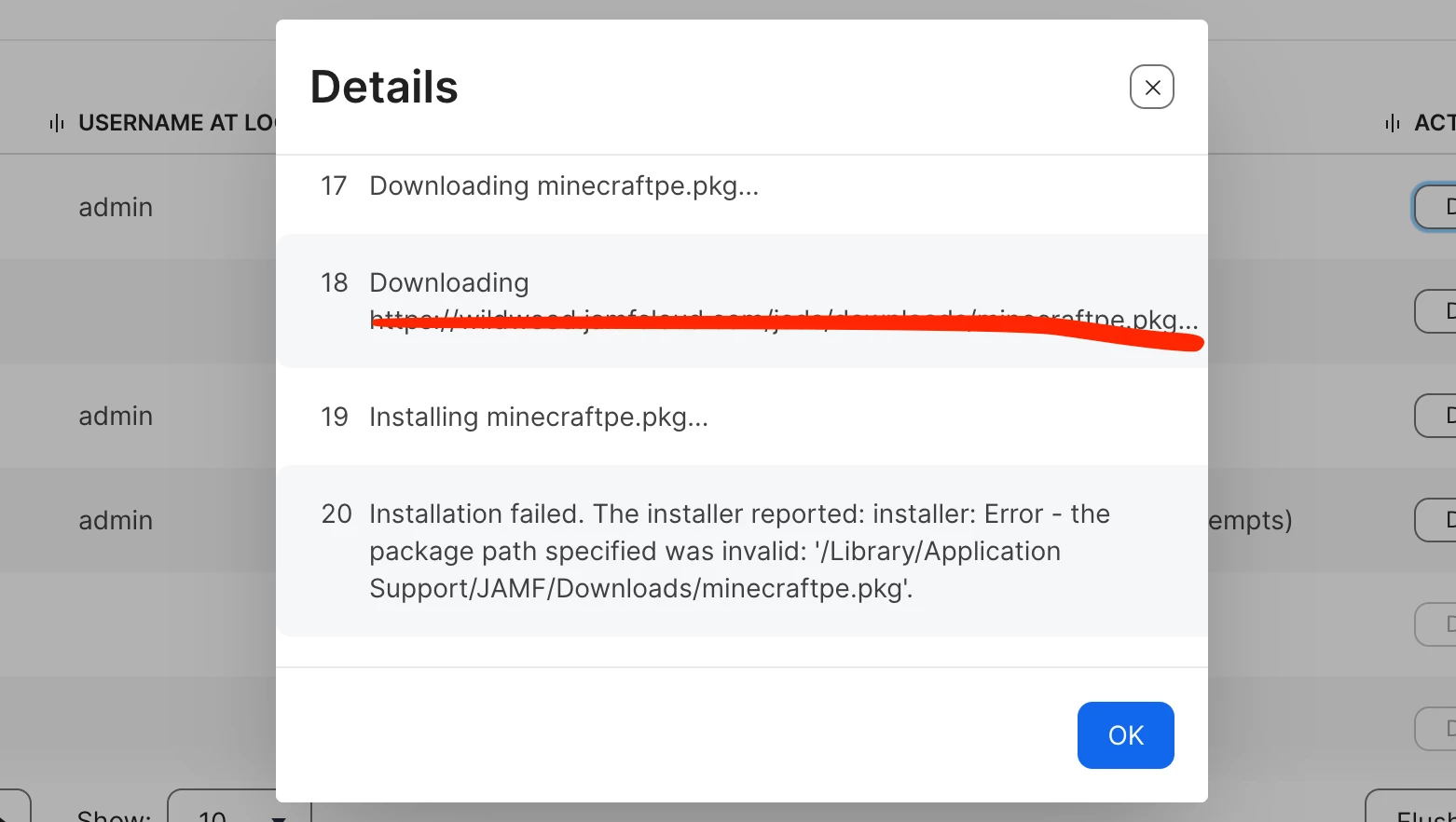

After searching for some suggestions I changed the package validation to never instead of "when checksum is present". This is the error after changing that setting. Any suggestions why it is not installing on the older MBAs?

Have you looked at the install log on the Mac? Does the package fail when manually installed? The jamf log is all well and good, but you probably want to have a physical test case that you can look at the local logs of to work out what is going on.

What version are the air's on, 10.13? Try using packagebuild (built-in) over composer to create the package, note I saw this returned;

- Check the package doesn't have OS restrictions.
