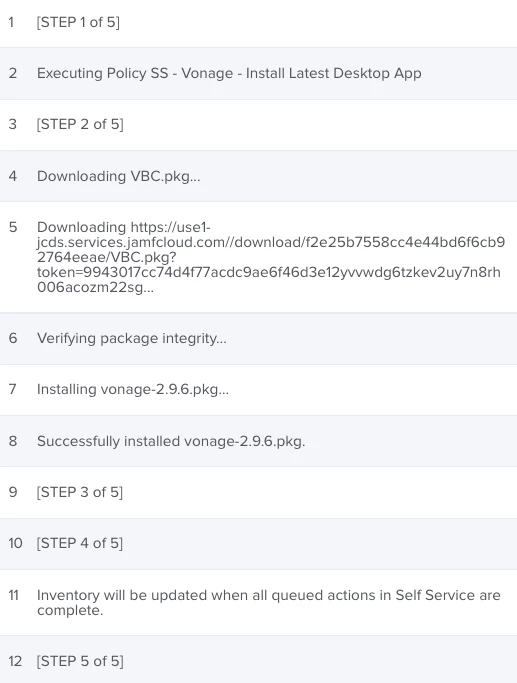

I'm running into an issue where an application is nowhere to be found on my machine (running 12.0.1) after installing a package that I uploaded into self service. The log from the policy shows no errors (i.e. the line says the package successfully installed), but the application is nowhere to be found. I ran the same policy on a machine running 11.6 and it worked as expected. Anyone else experiencing this? (Screenshot of log details below, exact same log for both attempts)

Okay that worked! I was able to download the package that way. I had to approve it in SysPref -> Security & Privacy, but the Installer seemed to work just fine. However, the application still does not appear in the Applications directory.
So to answer your initial question, no, the package does not install successfully. It appears to (like it does when installed from the Self Service app), but the application does not appear in the Applications folder.

Downoaded Suspicious Package at your suggestion. Unless I'm missing something, it's showing that the application was installed (using /usr/sbin/installer) into the Applications folder. There is a warning on the package that it isn't signed, but that shouldn't have any bearing on this issue, should it?

As best as I can tell, the application is not installed anywhere else on this machine. I tried reading the install.log file, but the only obvious error/warning I see is that the package isn't signed. (It's very possible I don't know what I'm looking at/for.)
