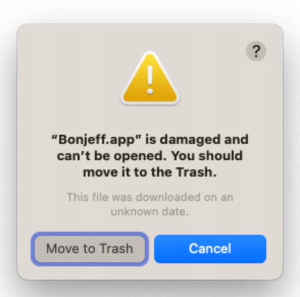

We are starting to see issues where installing locally via the payload file and postinstall.sh works fine but installing it after being packaged (either via Packages or PKGBUILD) results in the following error when launching the application (Pro Tools 2023.3.0 as an example here)...
' "Pro Tools" is damaged and can't be opened.  You should move it to the Bin.'
Following the help icon opens a page stating, "The app has been modified, and its code does not match the original signed code."

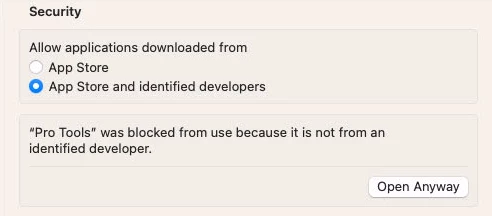

In Privacy and Security we can go ahead and choose to "Open Anyway" but this is not a viable way forwards for applications that we are trying to deploy hands-off.

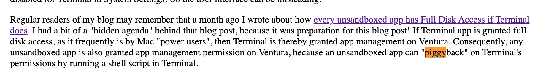

I found the article below while researching the issue. It looks like Ventura's security can be a bit overzealous when apps are modified. From my experience it looks like any app that has a helper tool that provides updates could be subject to this gatekeeper block. In my case, the jamf framework update seems to be causing this.
How macOS Ventura App Management works and doesn't work (lapcatsoftware.com)
I also noticed that some people on reddit found a workaround. The article above explains why this workaround works.

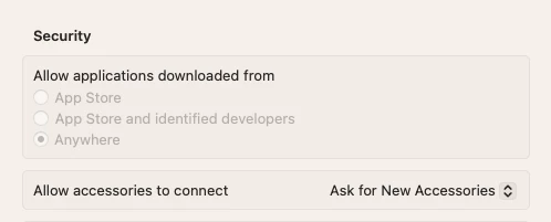

@Stuart_P , I want you to do a simple test for me. Make that pop-up appear again then navigate to System Settings> Privacy & Security >scroll down to the section in my picture below and tell me what you see.
