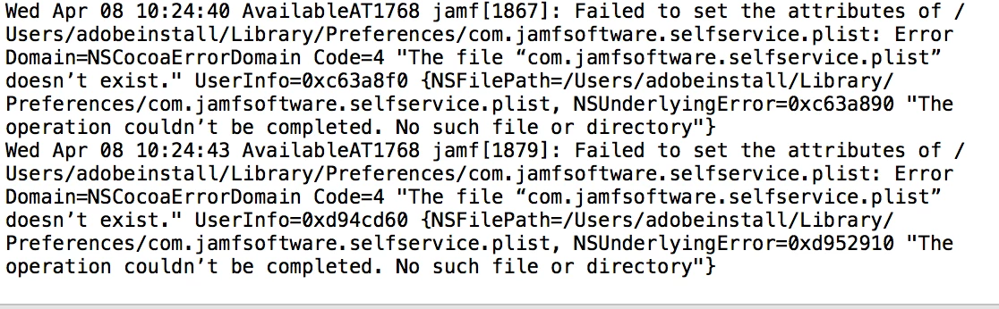

Here is an error I am getting from the /var/log/jamf.log file

Those errors don't seem to be stopping the script, they're just complaining about some missing preference files.
