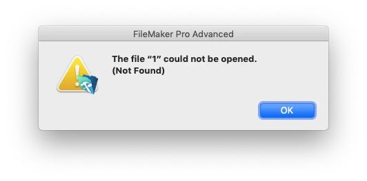

Hi All.. I'm hoping someone can shed some light please, as I seem to be able to use the revised AppleRemoteDesktopDeployment.sh script and also tried the zip upload to jamf self service all with success on the install. The only problem is i'm getting this error each time I open the application and I can't work out what it is relating to? Is the fmcert not loading or incorrect? If i change the Assisted Install.txt to 0, instead of 1 i get cant find "0".

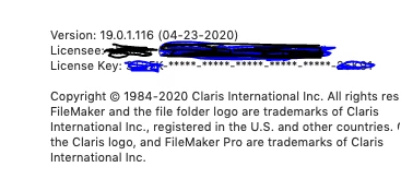

I just packaged up filemaker pro 19 using the script, assisted.txt, license.fmcert file and the app all in one folder. did the chmod to the script as the instructions say. edited the assisted.txt (nothing entered in license information line), suppressing dialogs, company name, kept the updates to inform the user that updates are available, but turned off the option to not notify of new versions
ran the script, uploaded the pkg, tested and the package installed. I run the application --> about filemaker pro and the license key information is displayed
