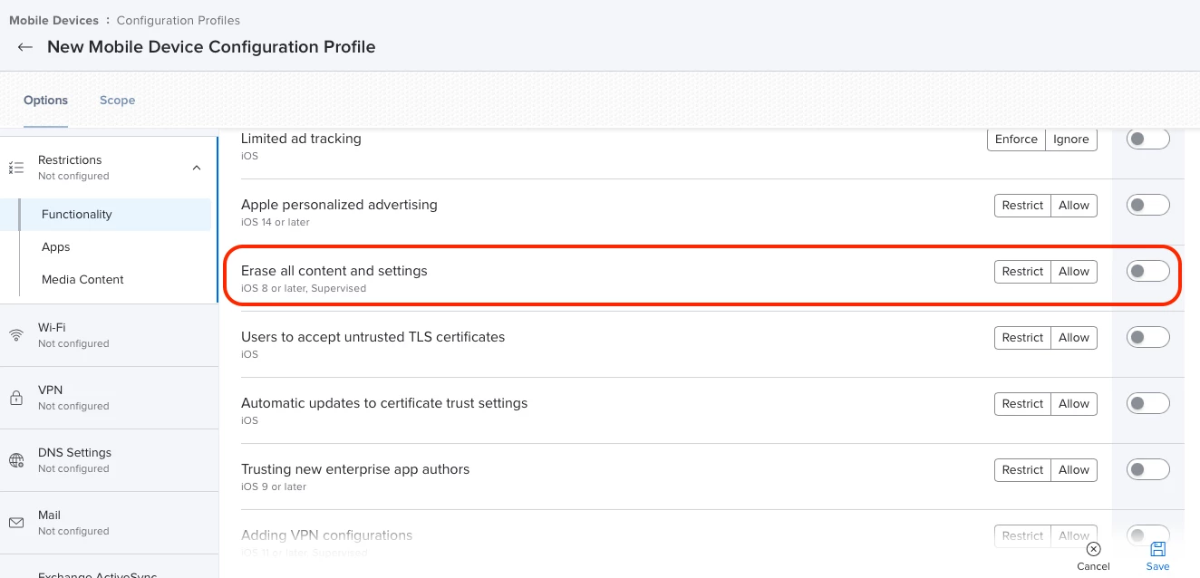

@BCPeteo Good Morning! If your iPads are supervised then the good news is YES. You can remove reset all settings and content from the reset menu. We have done this in our school district to prevent students from wiping their iPads. You can use a configuration profile to do this, in the restrictions payload.
I don't believe that they have to be in DEP in order to do this. You can use Apple Configurator to supervise them and add them into Jamf. DEP just makes life easy.

BCPeteo
  • November 8, 2021
Thanks for the reply. Actually part of our staff process is to erase the device on return, but we want to lock that from students. That's why I was wondering if there was a way to restrict just erase with a passcode. Does not seem like that is possible. Thought even if the device is wiped and connects to a network, since it is supervised it should automaticity get the our profiles and we could send a lost command to it.
