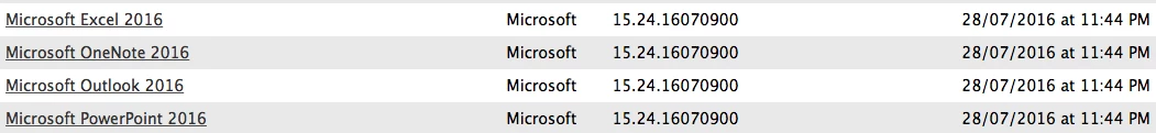

If I go into Patch Management for all the MS Office apps it is saying that current version is 15.24.16070900, but 15.25 was released yesterday (and announced on JAMF Nation!).
Do we need to do something to make sure the JSS knows when new versions are released?

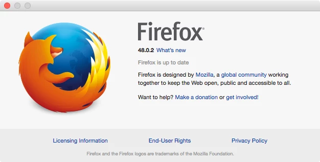

I received a Firefox 48.0.2 for Mac installer via AutoPkg and was able to confirm that it was actually Firefox 48.0.2.

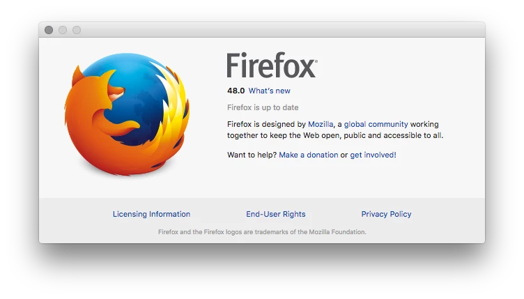

Weird...I never updated my installation of Firefox on my desktop until I read the responses this morning and got this...
No prompt for updating at all and still at 48.0.
I did receive via autopkg though a 48.0.2 but have yet to verify it is what it says it is.
