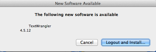

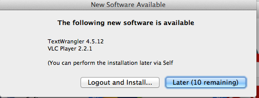

hi @emilykausalik , i have the core of it working fine. For some reason though, the first popup that triggers after running 'check for new software' doesn't display the info on packages properly.
Even though the api has pulled down the correct info from the package. I have verified this by checking /libary/application support/patchoo/pkgdata and checking the relevant files.
I also know its working as the bubble notification windows that show the package has downloaded displays it correctly.
See the screenshots below. The first one shows what happens immediately after running check for new software. The second screenshot shows it correctly, (every 2 hour check for cached packages that need to be installed)
Maybe I'm missing something obvious?
Thanks
