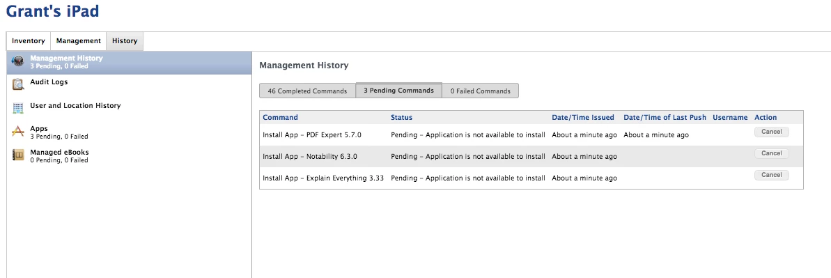

I'm trying to determine why certain apps will not install onto freshly enrolled ipad. Ipad 4, 16GB, with iOS Version 9.3.1 installed.
We have managed apple ids this year. We're running JSS version 9.93.
Could there be an iOS upgrade needed to install this app? What does the message in JSS mean? Please excuse my lack of info, I am a newbie at this.
Thank you
I was told that it takes time to assign the license from Apple. Those should go away on their own. It's just a timing thing. The App is scheduled for install but a license hasn't been assigned from Apple yet.

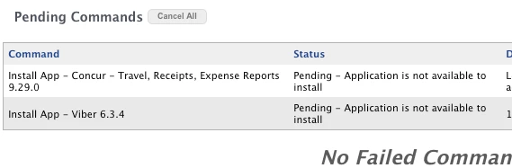

We are having the same issue. We have purchased 20 licences for apps, and assigned the app to 16 devices. Only 9 have the app installed. Some are giving this error and some are giving "Licence for app with iTunes Store ID 355395846 could not be found."
I'm having the same issue with one app (Interaction of Color - Complete Edition). Funny thing is, when I tested it last Thursday, pre iOS 10.1.1 update, the app was installed as expected. Post iOS 10.1.1, the app comes up with this error. All other apps install as expected (all are device assigned through VPP to a static group). Out of 25 devices, all had the same issue. I've tried scoping to individual devices, and this still happens.

From my testing, I think that quite some of those (probably not all) that get this error, are running into it because when you add the App in the JSS, with device based VPP assignments enabled, set to "install automatically) and scoped to some devices, there are two things happening at the same time:
1) The JSS talks to the Apple VPP Service to assign a license to the device
2) The JSS sends a push notification to the device, telling it to install the App
Now, if (2) is faster than (1), the device tries to get the app from the App Store but has no license, so it will fail for now, as there is no license available.
From my experience, (1) can take any time from seconds up to several minutes. So the workarounds that seem to work for me (given, everything else is fine):
- Either Wait a bit and do an inventory update, as this will trigger (2) again.
- Or when adding the app to the JSS, set scope, select device based licenses but set it to install through self service. Then wait a few minutes and set it to install automatically. With this, (1) is started immediately, (2) gain some time.
@Andreas_Schenk I totally agree. Not only for Auto-Installed VPP, but I think there is a similar issue with Self-Service installed VPP with MacOS. You press install, the App Store opens and says you have to buy the app but wait a few minutes and the app just starts installing!
We were having this problem for certain apps - it ended up that selecting the 'automatically update app' option was not selected on the ones that were problematic. Turning it on fixed the problem for us.
I know this post is a couple years back. However, last week I was having the exact same issue with the "Pending Available" reporting on the device for a couple of health science apps that were purchased. In my situation I had 25 iPads and 11 licenses of a Muscle App that were to be distributed. Being new Jamf I assumed that the app would be dispersed numerically because I have the iPads labeled iPad#1, iPad#2, etc...Instead Jamf randomly selected the iPads. So some iPads would have the app and others not. After I manually assigned the scope to target only 11 iPads for the app, then I was pretty much golden from there. Of course I had to send out remote commands to update inventory so those iPads who should not have the app the system would remove it. Then there were a couple of iPads that would not rid the app so I had to go into the Mobile Device App and set an exclusion for those iPads. Save, then I took the back out of the exclusion once I saw the app remove from those devices. I hope you were able to resolve your own "Pending Available" issue.
