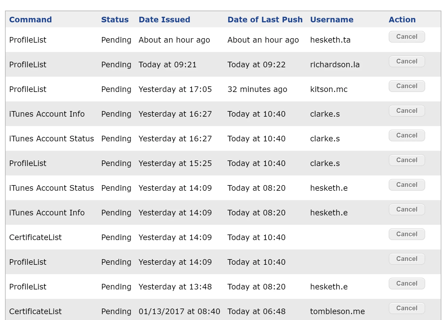

Getting this on most of our machines, becoming a real pain. Anyone got any ideas?

Any status on a fix for this? All of our lab machines at the school have multiple pending commands just like these. They are AD bound and students log in with AD accounts. It's been going on for years!
iTunes Account Status Pending Yesterday at 4:19 PM UserName Cancel
iTunes Account Info Pending Yesterday at 4:19 PM UserName Cancel
ProfileList Pending Yesterday at 4:19 PM UserName Cancel
iTunes Account Info Pending 02/02/2018 at 10:36 PM UserName Cancel
ProfileList Pending 02/02/2018 at 10:36 PM UserName Cancel
iTunes Account Status Pending 02/02/2018 at 10:36 PM UserName Cancel
iTunes Account Status Pending 10/26/2017 at 4:45 AM 01/19/2018 at 2:07 AM UserName Cancel
iTunes Account Info Pending 10/26/2017 at 4:45 AM 01/19/2018 at 2:07 AM UserName Cancel
ProfileList Pending 10/26/2017 at 4:45 AM 01/19/2018 at 2:07 AM UserName Cancel
iTunes Account Status Pending 10/24/2017 at 4:07 PM 01/19/2018 at 2:07 AM UserName Cancel
iTunes Account Info Pending 10/24/2017 at 4:07 PM 01/19/2018 at 2:07 AM UserName Cancel
ProfileList Pending 10/24/2017 at 4:07 PM 01/19/2018 at 2:07 AM UserName Cancel
iTunes Account Info Pending 10/04/2017 at 3:00 AM 01/19/2018 at 2:03 AM UserName Cancel
ProfileList Pending 10/04/2017 at 3:00 AM 01/19/2018 at 2:03 AM UserName Cancel
iTunes Account Status Pending 10/04/2017 at 3:00 AM 01/19/2018 at 2:03 AM UserName Cancel
ProfileList Pending 08/08/2017 at 5:37 AM 01/19/2018 at 2:09 AM UserName Cancel
iTunes Account Info Pending 08/08/2017 at 5:37 AM 01/19/2018 at 2:09 AM UserName Cancel
iTunes Account Status Pending 08/08/2017 at 5:37 AM 01/19/2018 at 2:09 AM UserName Cancel
iTunes Account Info Pending 05/17/2017 at 11:02 PM 01/19/2018 at 2:10 AM UserName Cancel
iTunes Account Status Pending 05/17/2017 at 11:02 PM 01/19/2018 at 2:10 AM UserName Cancel
ProfileList Pending 05/17/2017 at 11:02 PM 01/19/2018 at 2:10 AM UserName Cancel
iTunes Account Status Pending 01/26/2017 at 10:50 PM 01/19/2018 at 2:10 AM UserName Cancel
iTunes Account Info Pending 01/26/2017 at 10:50 PM 01/19/2018 at 2:10 AM UserName Cancel
ProfileList Pending 01/26/2017 at 10:50 PM 01/19/2018 at 2:10 AM UserName Cancel
ProfileList Pending 12/08/2016 at 1:15 AM 01/19/2018 at 1:58 AM UserName Cancel
iTunes Account Info Pending 12/08/2016 at 1:15 AM 01/19/2018 at 1:58 AM UserName Cancel
iTunes Account Status Pending 12/08/2016 at 1:15 AM 01/19/2018 at 1:58 AM UserName Cancel
ProfileList Pending 12/02/2016 at 12:43 AM 01/19/2018 at 1:58 AM UserName Cancel
iTunes Account Info Pending 12/02/2016 at 12:43 AM 01/19/2018 at 1:58 AM UserName Cancel
iTunes Account Status Pending 12/02/2016 at 12:43 AM 01/19/2018 at 1:58 AM UserName Cancel
ProfileList Pending 05/19/2016 at 1:05 AM 01/19/2018 at 2:09 AM UserName Cancel
iTunes Account Status Pending 05/19/2016 at 1:05 AM 01/19/2018 at 2:09 AM UserName Cancel
iTunes Account Info Pending 05/19/2016 at 1:05 AM 01/19/2018 at 2:09 AM UserName Cancel
iTunes Account Status Pending 05/18/2016 at 1:03 AM 01/19/2018 at 2:09 AM UserName Cancel
iTunes Account Info Pending 05/18/2016 at 1:03 AM 01/19/2018 at 2:09 AM UserName Cancel
ProfileList Pending 05/18/2016 at 1:03 AM 01/19/2018 at 2:09 AM UserName Cancel
ProfileList Pending 02/12/2016 at 1:19 AM 01/19/2018 at 2:04 AM UserName Cancel
iTunes Account Info Pending 02/12/2016 at 1:19 AM 01/19/2018 at 2:04 AM UserName Cancel
iTunes Account Status Pending 02/12/2016 at 1:19 AM 01/19/2018 at 2:04 AM UserName Cancel
iTunes Account Status Pending 09/29/2015 at 11:31 PM 01/19/2018 at 2:03 AM UserName Cancel
iTunes Account Info Pending 09/29/2015 at 11:31 PM 01/19/2018 at 2:03 AM UserName Cancel
ProfileList Pending 09/29/2015 at 11:31 PM 01/19/2018 at 2:03 AM UserName

  • October 4, 2018
@dgreening Can you confirm that the 'device_object_id' is the same as a Jamf Pro Computer ID, and the argument is changeable, depending on what device you want to remove the pending management commands from?
I'm by no means a MySQL expert....
  • October 4, 2018
From what Jamf told me, "device_object_id=12" pertains to user level configuration profiles. I have since de-scoped our on user level profile in favor of a system level. It is slowly being clawed back.
