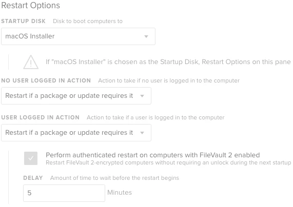

So I created a policy with a custom trigger that gets called from my script. The restart options are configured below:

My first test looks like it was successful. I'll be testing some more, but I'm glad I found a way to get this working. Thank you @wesleya!
