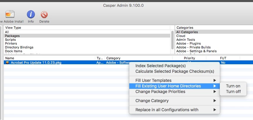

Thank you for that explanation, but that does not explain the behavior I am experiencing.
Especially not that I am able to choose FEU with a package and that it does have an effect...
What you're seeing is an appearance issue. Yes, those items should be dimmed when you're right-clicking on PKGs. Being able to choose them may lead you to believe they'll work, but they won't.

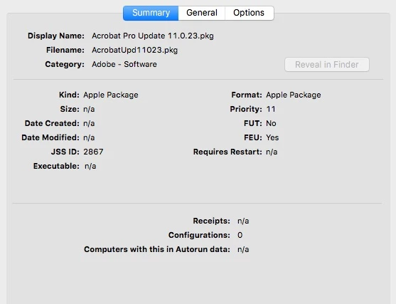

Well, maybe it is not supposed to make a difference, but when between two attempts of installing a piece of software only one component is changed, then that really does lead me to believe that said component made a difference. In one case it installs, in the other it doesn't. I repeated that process a few times, just to be sure. Please look at my screenshots...

@frank6502
This is a known issue that we have filed under PI-004562.
The options are available when they should not be (they should be greyed out) and, as you're seeing, it can cause errors if they're selected/used.
If you have not already, and would like to open a Support case to have attached to PI-004562, please get in touch with Support either by giving them a call, sending an e-mail to support@jamf.com, or using the My Support section of Jamf Nation.
Thanks!
