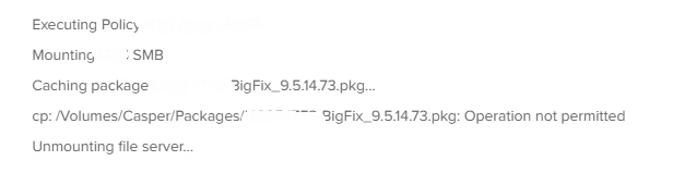

I'm using DEPnotify with a launch daemon that runs a Jamf policy with provisioning script. The script calls on other policies to deploy packages via custom triggers. Internally using SMB FSDP and just ran into the "CP operation not permitted" issue while working on Catalina and new 2020 MacBook Airs.
Creating a PPPC for /bin/bash and /bin/sh, with allow Network Volumes and All Files did the trick. I did not have to include Terminal, CP, or loginwindow for things to work.

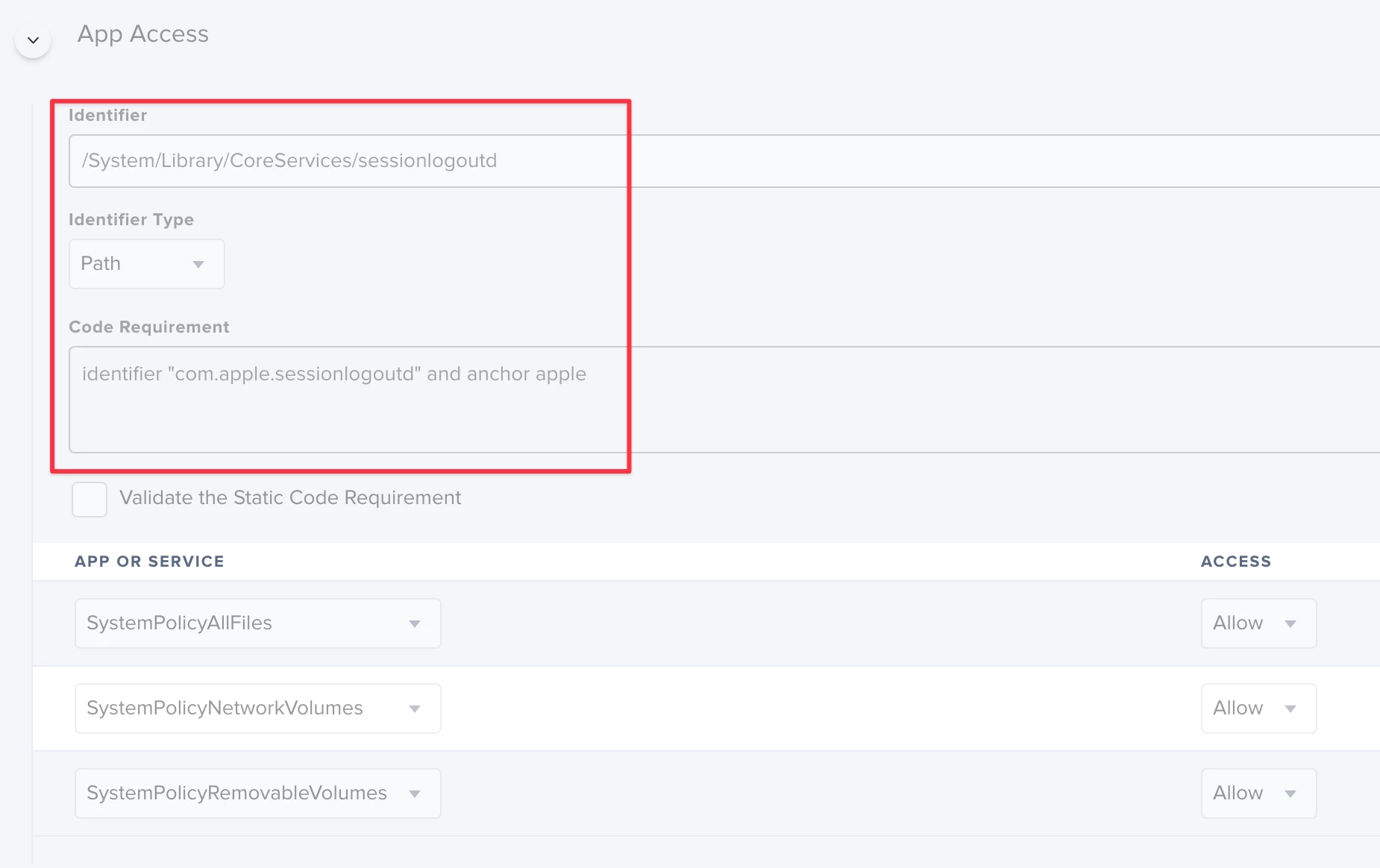

Do the following to whitelist stuff happening at logout:
Whitelist /System/Library/CoreServices/sessionlogoutd, using the identifier type path, with the code requirement identifier "com.apple.sessionlogoutd" and anchor apple
sessionlogoutd is the responsible binary that handles logout hooks, in the same way that loginwindow handles login hooks. Therefore, any logout hook script set here (including the Jamf logout policy process) will have access to anything that TCC allows, if the profile is set as per above.
In the example here, I'm allowing the logout process access to all files, network shares, and removable drives. Essentially to allow a Jamf Pro policy, fired at logout, to sync data to a network drive using rsync.

For 99,9% you will get a prompt that "Terminal.app would like to access files on a network volume". It's obvious as you're using Terminal to trigger this policy... so what if you're using Jamf Pro and would like to install something that is on your SMB share? Looks like DP is mounting and then copy command is executing. Nothing big, but during this proces the parent of this command is bash. In case of that you have to allow /bin/bash to access SystemPolicyAllFiles via Privacy Preferences Policy Control payload under configuration profiles.
