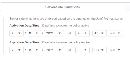

@dmarcnw @davidacland @Aziz
I added time frame under server-side limitations, but i didn't get any information on mac. What should i do then?
