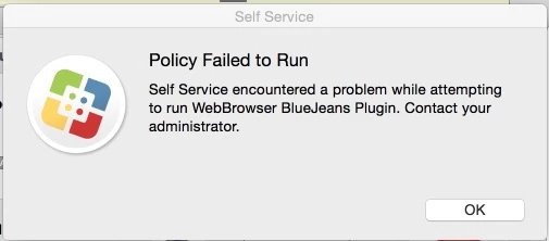

Starting from last 2 week, we started facing issue with self-serivce. When user try to install app from Self-Service, it throws below error;
Any idea what could the cause?

Is there any more information in the policy log on the JSS?
Thanks Davidacland
it just says

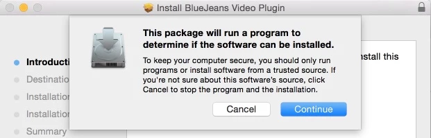

I tried manually executing the pkg and I get this message, when I click continue, no further response;
Does the system log show any more detailed information?
No! :(
