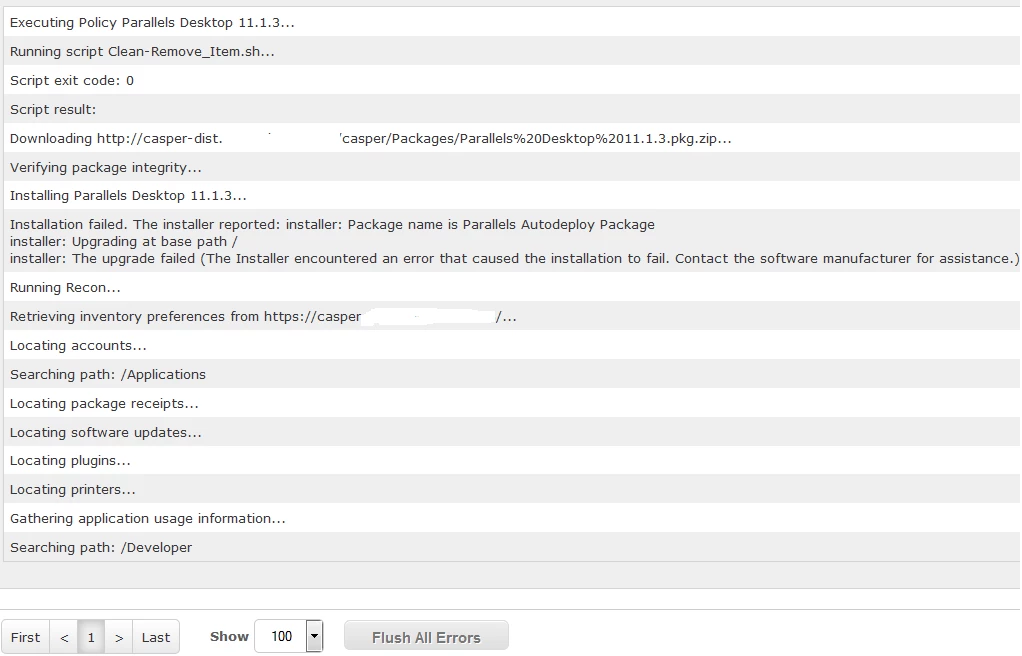

hey guys
I have a policy to install and I am getting strange results
On the Jamf dashboard logs, it is saying it has failed but when I pyhsically check the client machine its installed and working...
Any idea's ?

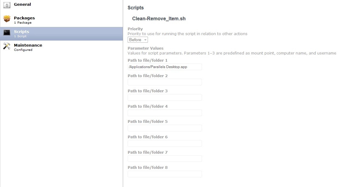

The only script I have put is a script to remove any existing installs of the app which executes before the installation
Mind you, I have tested this on other machines and it has worked ok. Just a little worried it will fail on half of the machine when I roll it out to users
here is my script:

It's possible something in that script (Clean-Remove_Item.sh) is making it cough a bit. The install log is /var/log/install.log. It will usually have some good details about what is causing an error.
  • March 17, 2016
Actually - looking at your first image more closely, it looks like the Clean-Remove_Item.sh script exits 0 before the installer itself runs. So maybe it's a postscript in the installer itself. Either way, scrounge around for errors or failures in the log file.

Yes I did not think it was the Clean_Remove_item.sh script as this happens before the installation of the app and I did also see the exit code 0 to which means no error

But here is the log of when it did fail:
LSOpenURLsWithRole() failed with error -10810 for the file /Applications/Parallels Desktop.app/Contents/Applications/Parallels Link.app.
Mar 18 09:40:17 C02HTCKYDRVD pdfm-bootstrap[82803]: inittool[82779]: '/Applications/Parallels Desktop.app/Contents/MacOS/Parallels Service' - incorrect permissions (0755)
Mar 18 09:40:17 C02HTCKYDRVD installd[1139]: ./postflight: Mar 18 09:40:17 C02HTCKYDRVD pdfm-bootstrap[82803] <Error>: inittool[82779]: '/Applications/Parallels Desktop.app/Contents/MacOS/Parallels Service' - incorrect permissions (0755)

If the script is spitting out "error" or "fail", even though the script exits as 0, and the policy is succeeding but JSS is reporting it failed, this is fixed in 9.82.

In my experience, the "LSOpenURLsWithRole" error usually means an action was attempted as a user that has no access to a valid GUI login session. In your case, the installer is trying to launch "Parallels Link.app", which I'm guessing requires such a session in order to do its job. You probably wouldn't get the error if your policy was executed as a Self Service item.
