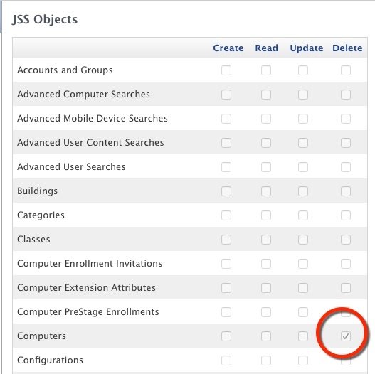

@msnowdon You'd need to modify the username, password, and URL for your environment. I have added logging and some error checking, but that's the heart of it.
I created a JSS user account that only has access to delete Computers specifically for this purpose, and those are the credentials in the script.
