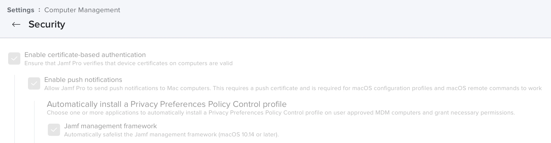

@Bol   so out of the box, JAMF isn't configured so that jamf management and jamf daemon can manage the Mac without restriction?
You can enable this in security as below. Unless something has changed in the last few Jamf Pro versions that i've missed, it still only whitelists the helper applications as opposed to the parent bundle id.
This is where things got tripped up after some hardening by Apple.
For me, I was using Apple Script to interact with terminal / finder etc. on a login script.
In our instance, we deploy a custom PPPC config profile; the "Automatically install a Privacy Preferences Policy Control profile for "Jamf management framework" is NOT checked.
Same, although it doesn't really matter if it is or isn't selected with a custom payload as the higher permission profile should take precedence.
