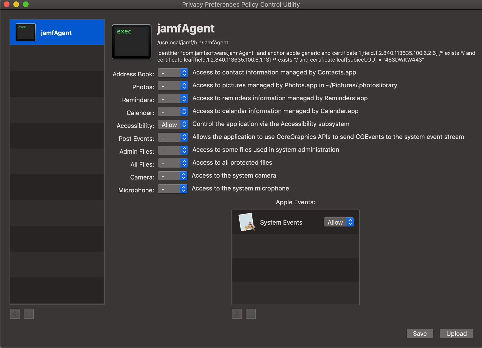

I have a issue with PPPC I cannot get rid of

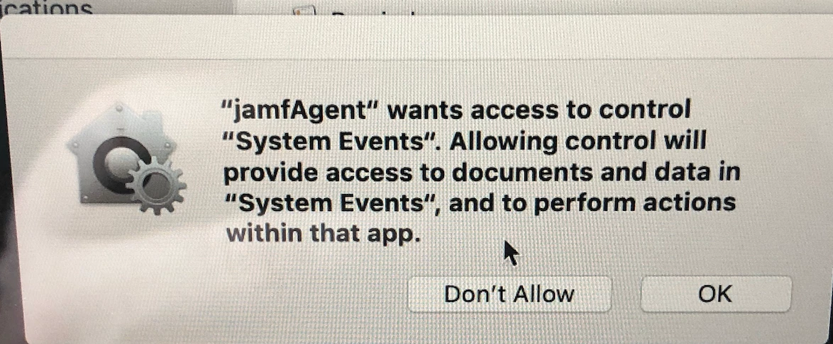

Just before this scripts it called the following popup appears
I have of course used the PPPC tool and set it up the following way but it keep showing up. I have checked the macs and the config profile has been loaded, so cannot understand why this keep popping up when I have created the matching PPPC
Do anyone has an idea what is going wrong

Here's another good resource for generating a profile that will whitelist jamfagent and the Jamf binary for various AppleEvents: https://github.com/rtrouton/privacy_preferences_control_profiles/tree/master/Privacy%20Settings%20Whitelist%20-%20Jamf%20Notifications

In addition to what's being stated above about the latest versions of Jamf Pro auto installing a PPPC Profile that whitelists the entire Jamf toolset, you also need to add /usr/bin/osascript to a PPPC profile to whitelist. It's not the Jamf binary specifically in your script that's causing the pop up, it's osascript. You can tell that by the fact that it's asking for control over System Events, and in your script you have this code:
countryValue=`/usr/bin/osascript <<EOT
tell application "System Events"
As indicated, you are telling osascript to tell System Events to do something, but because it's not whitelisted to allow that, it's causing the prompt to come up.

@mm2270 I just added the osascript to the PPPC and allowing systemevents. Just tried on a brand new mac I got in and even the pick country policy stand as "completed" nothing was prompted on enrollment. It just skipped the prompt and not even asking about the popup(this error that it sometimes just skip the whole policy have seen before on some few new clients)
