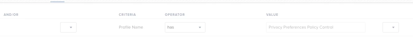

@Cayde-6 I scope to the presence of the Jamf-supplied PPPC profile that gets pushed upon the user's first login post-Mojave upgrade.
mm2270
  • March 18, 2019
I like that method @sshort. I hadn't thought of that, but that actually makes sense from a global scoping perspective since only Mojave systems and higher would have that Jamf PPPC profile installed.
