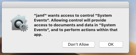

Trying to wrap my head around this. Had a couple of instances with new Mojave builds where the Jamf agent was called.
We already upgraded to JSS v10.7.1 so it's not the agent requiring access but likely a policy which needs access and the message is piped through the agent. Do you compile a complete list based on testing all the installed apps and policy's and then upload it to the jss or do you break it down somehow?
Approving Terminal first I can see which application are in the TCC list (sqlite3 /Library/Application Support/com.apple.TCC/TCC.db "SELECT * from access") but it doesn't show me which events they require.
Runnning the following: (/usr/bin/log stream --debug --predicate 'subsystem == "com.apple.TCC" AND eventMessage BEGINSWITH "AttributionChain"') shows me the process running but doesn't seem to correspond to which application calls them.
My main question How do I know which application needs to be pre-approved and with what specific action?

@kerouak is correct, we pre-built a profile that would whitelist the Jamf Binary, Jamf Agent and Jamf.app to be able to communicate with SystemEvents, SystemUIServer and Finder via the Apple Events service listed within the PPPC framework. That JamfAppleEvents.mobileconfig profile can be found here: https://github.com/jamf/JamfPrivacyPreferencePolicyControlProfiles and is linked in our KB Preparing Your Organization for User Data Protections on macOS 10.14
We do not plan to auto-whitelist terminal to communicate with things since that should be an Admins choice about what other applications they want to allow to communicate with things. Also, if an admin is running something via terminal they can click the allow button themselves.

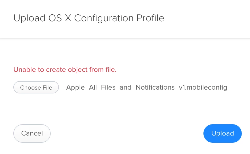

In addition @mike.paul when I try and upload pre created config profiles I get the following error:
Is there something I need to do to the file before uploading?

Hi @mike.paul sorry, I may have not been clear. The upload error happens when I try to manually upload a .mobileconfig file through the Jamf Console. Upload via the PPPC Util does not have issues.
How was that profile created and what is its contents? Would you care sharing it here? I just manually uploaded a profile saved from the PPPC Util and one I manually wrote out and both uploaded without error.
@mike.paul I am even having the issue with the JamfAppleEvents.mobileconfig file on your GitHub repo.
Im guessing your browser modified the file prior to downloading. When I right click on the .mobileconfig and download it in Firefox and open it in a text editor I see it starting with

The above values are not correct. Your file should look the same as it displays in GitHub, looking similar to this:
<plist version="1.0">
<dict>
        <key>PayloadContent</key>
        <array>
                <dict>
                        <key>Services</key>
                        <dict>
                                <key>AppleEvents</key>
                                <array>
So your options to not have your browser mess with it is:
I think I've seen a duplicate identifier cause that "unable to create object from file" error ... possibly a number of reasons.

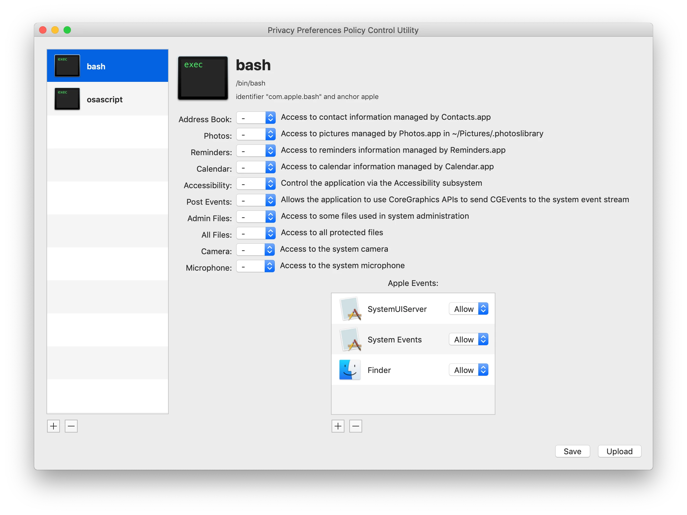

Anybody else having issue with the PPPC utility and making a scrip.sh be allowed to manipulate finder? It wont let me select a .sh file.

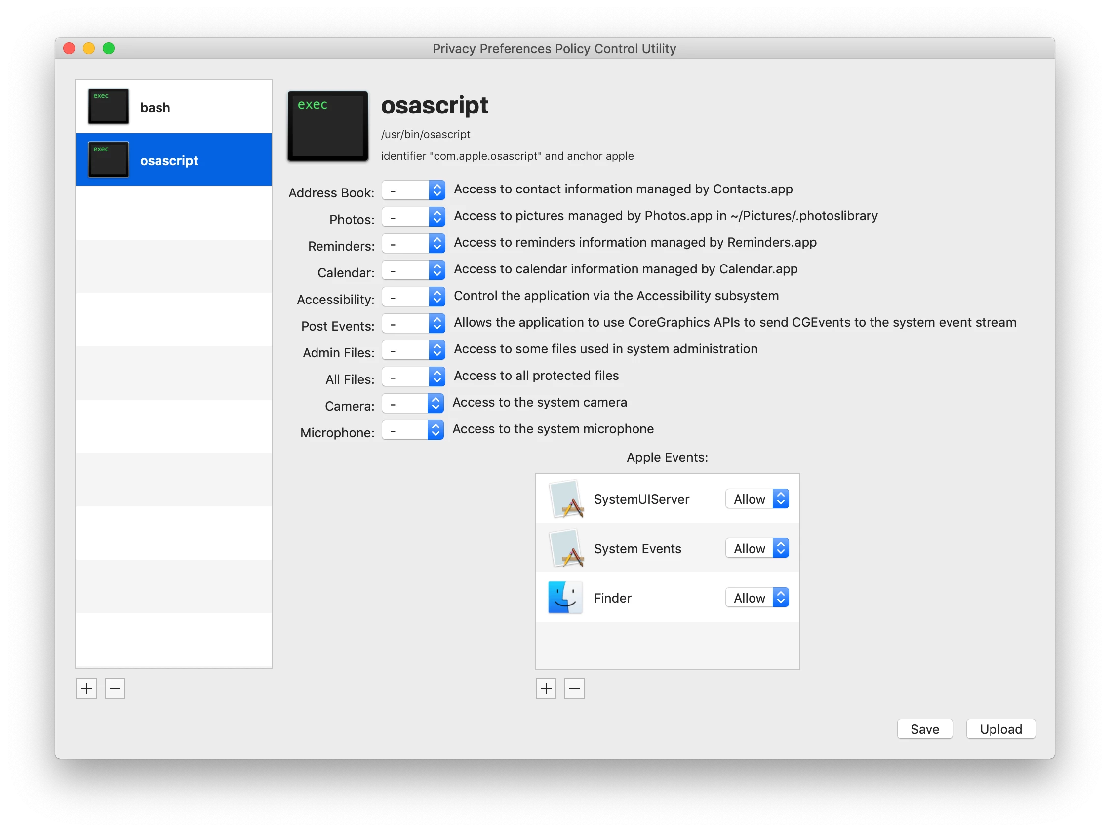

I tried the utility to add bash and osaacripts to be allowed but still same pop up
@szultzie, unless you signed your script and/or self made apps, it won't be allowed to be whitelisted as that is a requirement for PPPC. The PPPC utility will give you better display of why it is denying things in a future version.

Yes, you can whitelist anything that is signed, whether that is an app, binary or a script.
Since bash is a binary is signed by Apple you could whitelist that, its identifier would be /bin/bash and its code signature requirement would be identifier "com.apple.bash" and anchor apple.

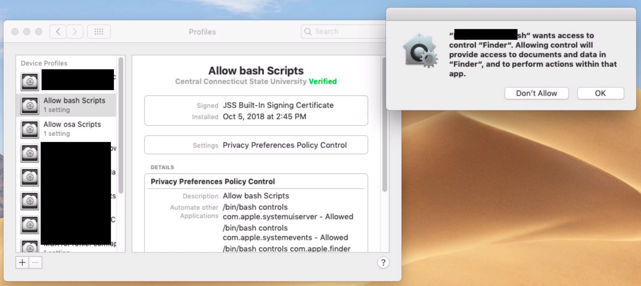

For example, when I run a shell script from terminal that has osacript inside that is doing a call to Finder (common workflow for end user prompts), I see terminal as my parent process to whitelist. Logs from that show:
2018-10-08 09:20:44.376179-0500 0x2a409c   Info        0x0                  341    0    tccd: [com.apple.TCC:access] AttributionChain: RESP:{ID: com.apple.Terminal, PID[17885], auid: 501, euid: 501, responsible path: '/Applications/Utilities/Terminal.app/Contents/MacOS/Terminal', binary path: '/Applications/Utilities/Terminal.app/Contents/MacOS/Terminal'}, ACC:{ID: com.apple.osascript, PID[18161], auid: 501, euid: 0, binary path: '/usr/bin/osascript'}, REQ:{ID: com.apple.appleeventsd, PID[69], auid: 55, euid: 55, binary path: '/System/Library/CoreServices/appleeventsd'}
With the one being responsible for the call being RESP:{ID: com.apple.Terminal, and the thing its requesting access to being REQ:{ID: com.apple.appleeventsd,
yes, so after some more testing...
I do have bash whitelisted, and adding the line <string>/usr/bin/bash</string> in my launch agent that calls the script, it doesn't run at log in now. When i call the scrip from terminal it runs but my new item being blocked is terminal, which makes sense based on what you say that my new parent process is terminal, and bash is white listed so the script doesn't get flagged.

So just an update... adding the <string>/usr/bin/bash</string> or <string>/bin/bash</string> causes the launch agent not to launch. Wait to hear back from Jamf Support.
