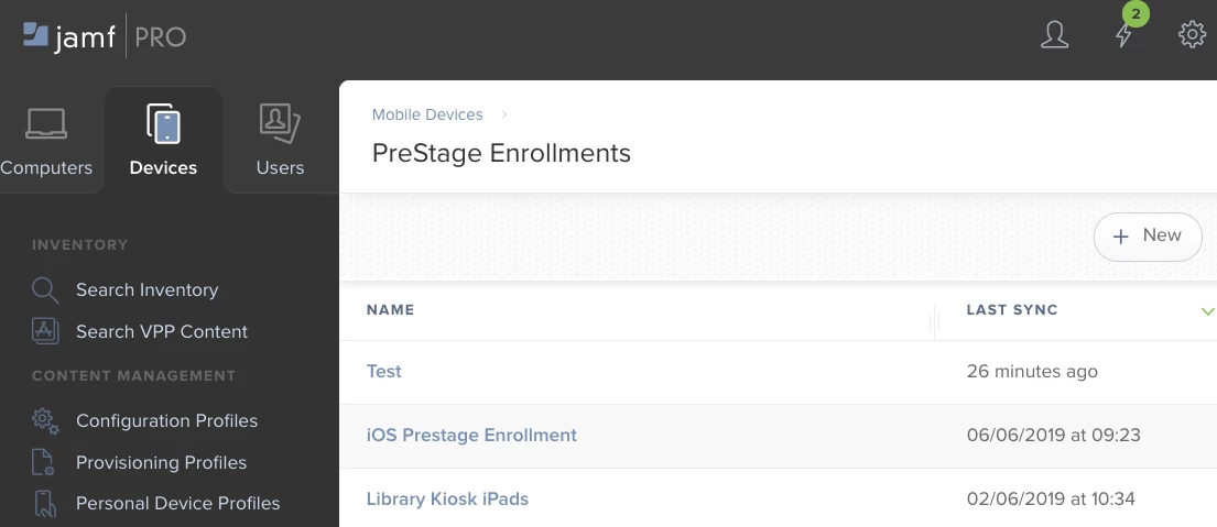

FutureFacinLuke
None of mine have Synced since 6th June but I was able to make a new one.
A bit of a problem as new devices go to iOS by default and I need to move one I just Assigned to Library Kiosk...
FutureFacinLuke
I was able to work around the above by unchecking Automatically add new devices then saving, going back into the iOS PreStage and removing the device from scope.
Since the changes to DEP and the addition of Auto Assigning devices in AMS I have found DEP for both Macs and iOS a bit slower and more cumbersome to use.
