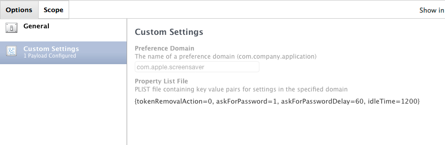

I use a custom Config Profile to set display sleep.
{tokenRemovalAction=0, askForPassword=1, askForPasswordDelay=60, idleTime=1200}
This enables the screen saver in 20 minutes, and requires a password after a 1 minute delay. This is configured this way because our security policy requires screen lock within 20 minutes of idle. Added benefit users can still modify the computer sleep and display sleep to their hearts desire.
idleTime you could set to 3600 for 60 minutes.
I'm not sure how this might interact with your config profile to log the system out after 60 minutes.

The built in profiles are not flexible enough. If you wanted to ensure they couldn't lock you could set askForPasword=0 instead of 1.
I use the following profile settings to make em stick.
Distribution Method
Install Automatically
Level
Computer Level
davidacland
