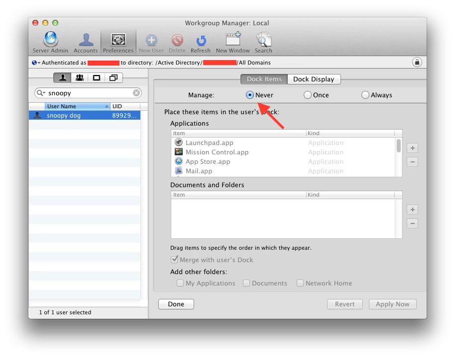

I'm wondering if there's a way to prevent an AD-bound computer from picking up Managed Preferences that seem to be defaults when we create a new user in AD.
For example, I have to keep a computer around with Mac OS X Lion that can run Workgroup Manager just so I can switch off "Dock" and "Login Items" from the user's account in AD after we create a new user.
I'd like to find a way of not having to do this anymore.

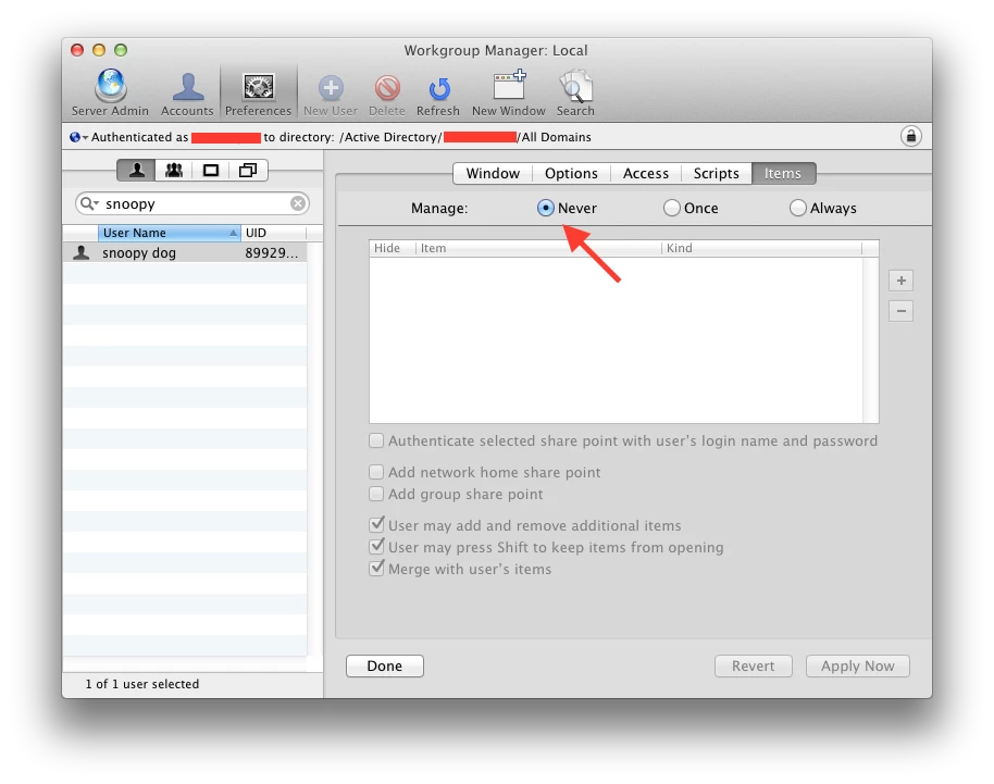

We've removed all the Managed Preferences from AD, but three always get created automatically when we create a new user:
- Mobility
- Login
- Dock
I then have to click the "Never" radio button on the last two because I won't want them interfering with Config Profiles or plists that we're setting up as defaults at the computer. The most annoying one is the "Login" because it automounts the network home share (but not the user's actual network home folder).

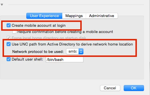

I'm not sure if I should also just hit the "Never" button in the mobility since those same settings get created when we bind the computer to AD anyway. I can't remember if there were any adverse effects from doing that.

The Mobile and Login are because you set those preferences in the AD plugin.
