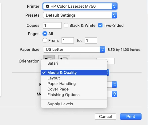

I am definitely seeing a difference with my printers... Below are screenshots of my HP Color Laserjet M750 before and after 10.14.6
Before
After 10.14.6

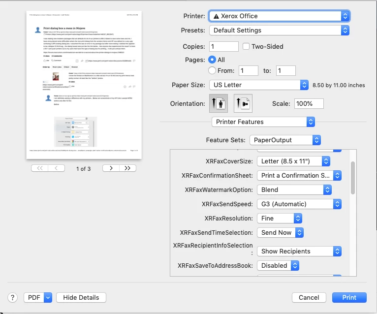

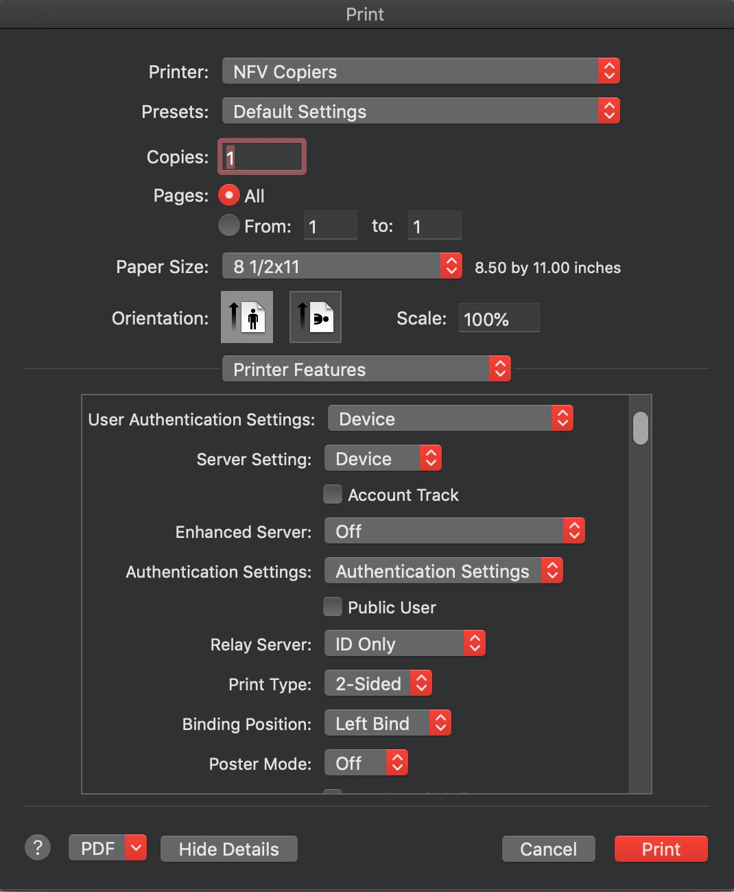

Apple Isn't allowing sandbox access to print drivers anymore. Take a look at mine and be happy with yours. Notice the scroll box.
Touché
My Xerox...
What a car wreck...

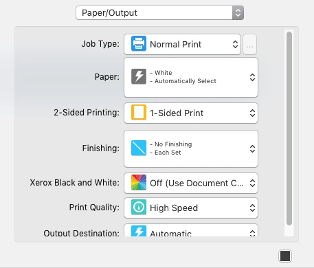

Yep... I’m with all of you! I quite liked the xerox layout... even I have trouble puzzling out certain finishing options now, let alone a regular user!
It appears the issue has been resolved in macOS Catalina. The Xerox print dialog now appears correctly.
@rgerman What app did you test printing in? Do you see the proper Xerox print dialog in Safari?
Safari looked correct as well. I am using the XeroxPrintDriver_5.3.0_2118.dmg from Xerox's site.
