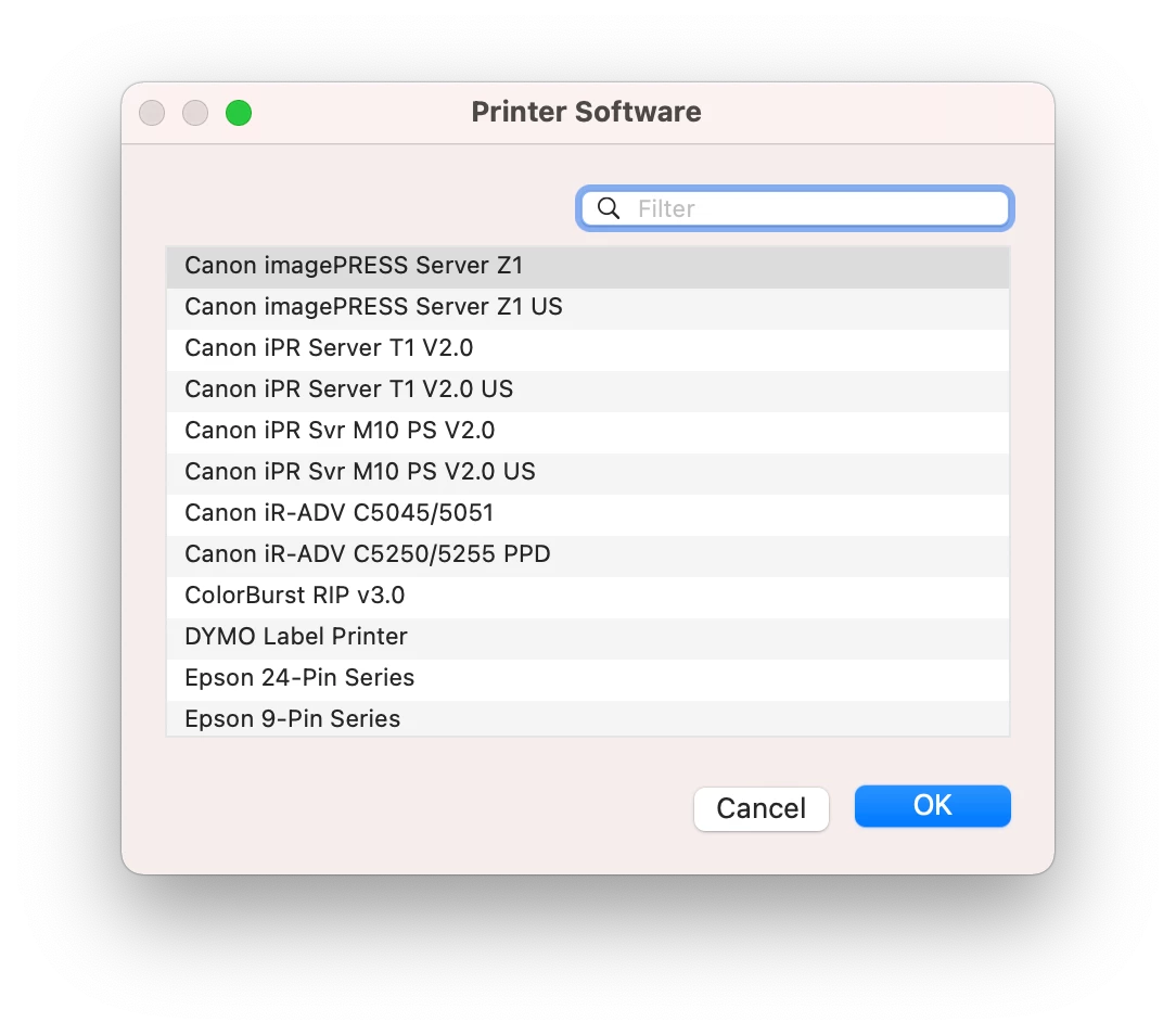

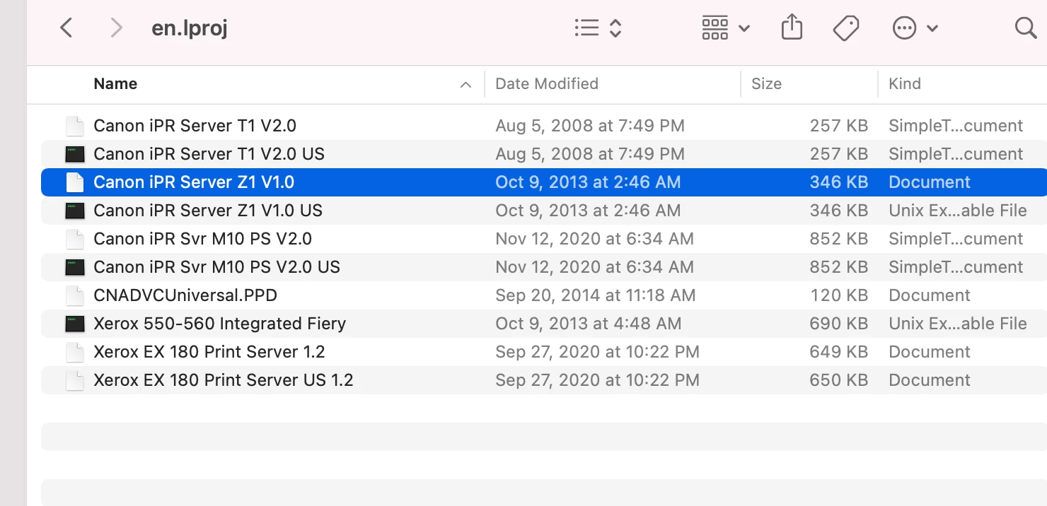

@stevewood Thank you for helping me with this!
Got it to work!
But I have another printer but this one doesn't have gz or ppd.
I have the driver installer and it installed but when I went to look for ppd or gz.
It has Unix executable file and texEdit
See the pic. "Canon iPR Sir M10 PS V2.0 US"
Is there a way to point this using a script without breaking?
  • February 1, 2022
Got it to work!
Nevermind! Got it to work :)
This worked:
/usr/sbin/lpadmin -p Test-printer -E -v lpd://$CURRENT_USER@<ipdaddress> -P “/Library/Printers/PPDs/Contents/Resources/en.lproj/Canon iPR Svr M10 PS V2.0 US”
I thought about erasing the post but in case anyone else who is new like me, they can give this a try :)
