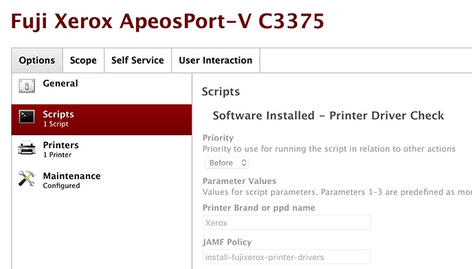

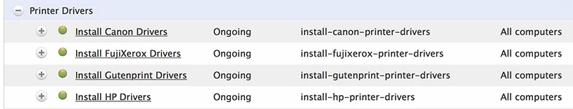

We have all of our printers managed by print servers.
I create the printer objects using the CUPS web interface, then upload them to Casper Admin. All printer objects point to the print servers (lpd://printserver1.companyname.com/printer123)
I have a Self Service policy for each printer object which also includes a script that determines what type of printer is being installed (canon, xerox, etc). If the driver is not installed, another policy is kicked off to install the driver before adding the printer to the computer. I use custom triggers for this.
These are my install printer drivers policies:
This is one of my Self Service printer policy:
